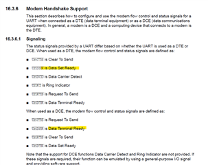

  • How can I find out more about these items in the TivaWareTm Peripheral Driver Library?  How can I find out what causes a DSR interrupt?
    30.2.2.30 UARTIntEnable
    Enables individual UART interrupt sources.

  • Hi Mark,
      If you are not using UART in modem or flow control mode then you should not be getting the DTR error. DSR is for Data Set Ready. Are you getting an DSR interrupt?
      Also wanted to give you heads-up that I will be on vacation tomorrow until the end of the week. My response will be delayed.
  • Thanks for the heads up on your schedule.  I am not getting that interrupt, I just pulled out one that I didn't immediately recognize.
    If I may ask, what document did you quote here?  Is that a TI document.
  • Yes, it is from the datasheet. Just search for DSR in the device datasheet.
