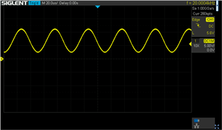

I have custom HW on which I can run your example project: resolver_angle_speed_am263px-cc_r5fss0-0_nortos_ti-arm-clang from SDK 9.2.0.56.
I have to comment out the multiplexing since it's NA.
    //Board_driversOpen();
    /* setting up resolver related pins on board muxes */
    //i2c_io_expander_resolver_adc();
And also change the excitation output from D16 to D17 but that's it. Here's the excitation sine wave to my resolver with the example project:
And the example output:

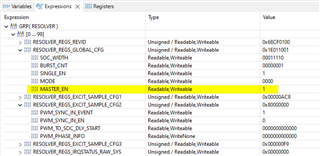

    So for example, presumably RESOLVER_REGS_GLOBAL_CFG.MASTER_EN must be set to get a PWM output. Is that correct? Perhaps not, I don't know. The point is that I'd like you to tell me what registers to check to try to find the cause of no PWM output.
  • Hi Kier,
    Please check the Resolver registers,
    1. see if the master_en bit is set. in RESOLVER_REGS_GLOBAL_CFG bit 0
    2. see if you have the pwm sync en. in RESOLVER_REGS_EXCIT_SAMPLE_CFG2 bit 29
      1. if enbaled, then see sync_in_event status. in RESOLVER_REGS_EXCIT_SAMPLE_CFG2 bit 31
      2. if not, no need to check.
    From the reset defaults, these are the Resolver registers you'd need for the Resolver to generate a 10KHz Resolver PWM out. if your IOMUX is configured correctly, then the waveform should be available.

  • Thank you very much for the comprehensive debug points. I think these will be very useful.
    • see if the master_en bit is set. in RESOLVER_REGS_GLOBAL_CFG bit 0
    • see if you have the pwm sync en. in RESOLVER_REGS_EXCIT_SAMPLE_CFG2 bit 29
    Thank you. Here's the resolver registers:
    with respect to the resolver (and PWM sync and PWM Xbar configuration) configurations, there should not be any issue with the Resolver generating a PWM out signal.
    OK, thanks for the confirmation.
