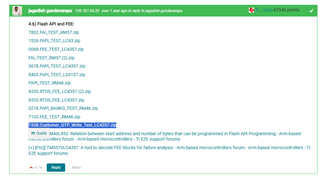

You can find example project for OTP writing here:
