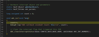

I am trying to run ADC0 Channel 0 in interrupt mode. While the ADC interrupt is working, the callback function is not being invoked as expected.
Could you please review the code snippet below and let me know what might be missing?
Additionally, I have reviewed the MCU+ SDK 10.02 example adc_soc_continuous_dma. I noticed that two callback functions are defined in the example, but neither of them appears to be triggered by any interrupt.
Looking forward to your guidance on this issue.

here is my code
Note- Code is working fine ADC conversion is proper as per input voltage.

void adc_isr(void *arg) //this function is callback function for adc need to check is not calling
count++;
DebugP_log("call adc callback \r\n");

  • Hi Vipul
    Could you also share your syscfg file with me?
    Akshit

  • Hi Vipul
    this issue is occurring as you haven't configured the INT_XBAR to route the ADC interrupt signal to VIM.
    With this you'll also need to register the intnum as that of the INT_XBAR:
    // Initialize HwiP parameters
    HwiP_Params_init(&adc_params);
    adc_params.intNum = CSLR_R5FSS0_CORE0_CONTROLSS_INTRXBAR0_OUT_0; // Use crossbar output
    adc_params.callback = &adc_isr;
    adc_params.priority = 10;
    attaching the complete code file below:

     // Hardware interrupt object and parameters
    static HwiP_Object gAdcHwiObject;
    static HwiP_Params adc_params;
    long unsigned int count = 0;
        count++;
        DebugP_log("ADC callback invoked! Count: %lu\r\n", count);
        // Clear the interrupt flag that triggered this ISR
        ADC_clearInterruptStatus(CONFIG_ADC0_BASE_ADDR, ADC_INT_NUMBER1);

    With this I am able to confirm the callback is working and am also able to break into it:
    Akshit
  • Hi Akshit
    Thanks for the quick support now its working......
