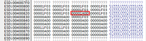

What I observe in the system MD_STAT register block is that all module domains I configure end up in a "good" state 0x1F03, but the EMIF_CFG_0 domain ends up at 0x1A0D, which doesn't appear to mean anything according to the listed enum values in the SDK.

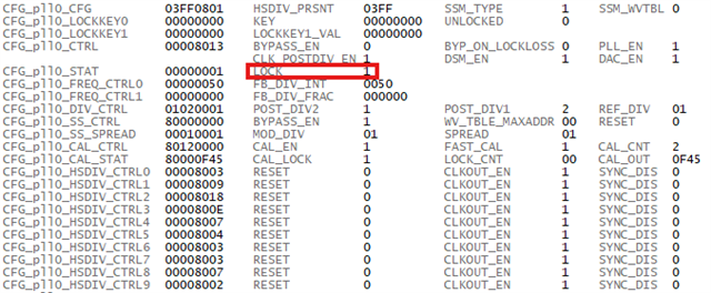

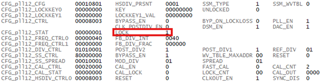

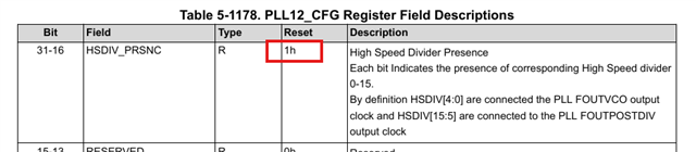

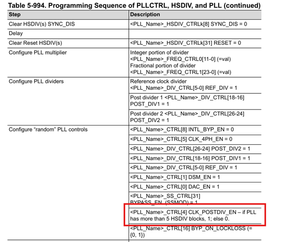

    The problem was that I followed the TRM PLL configuration instructions, or I've misunderstood the intent. Table 5-994 lists this statement:

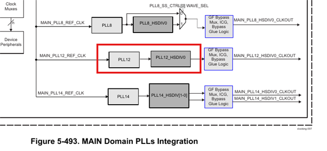

    So naturally, I have a check in my software that counts the number of set bits in HSDIV_PRSNC in the CFG register. PLL12 lists only 1 divider.
    This also matches up with the block diagram of the PLLs:

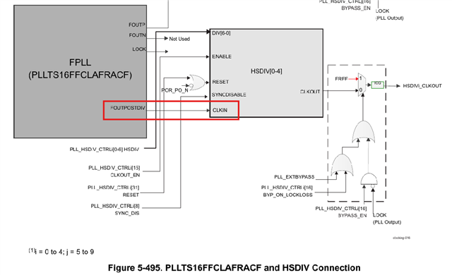

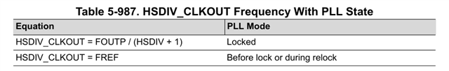

    The fix? CLK_POSTDIV_EN must always be enabled irrespective of the HSDIV_PRSNC count. Not sure why this is the case, but the TRM needs updating to not include that instruction. Reading the description for that bit shows if 0, all synchronous divided clocks are held low, HOWEVER, Table 5-987 claims this shouldn't affect the HSDIV because its clock is sourced from FOUTP, which is not gated by CLK_POSTDIV_EN.
    This is confusing, because just one page further, you get this diagram, showing that HSDIV[0-4] is actually sourced by FOUTPOSTDIV.
    I understand now where I went wrong, but I really feel the TRM could improve by removing/clarifying the instruction to disable CLK_POSTDIV_EN.
