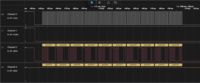

I’m working on the TMS570LS1224 LaunchPad and trying to implement MibSPI3 transmit using DMA (TX-only). I’ve successfully implemented MibSPI3 without DMA, but DMA TX is not working despite trying several approaches. There is no GUI support for MibSPI DMA in HALCoGen (v04.07.01), so I’ve manually configured DMA via code. It will be very helpful if you support with DMA RX also. i will attach the screen shoot of logic analyzer also for reference.

Without DMA :
With DMA:

Mag Issue:
DMA transfer never seems to take place.
Data is not moved to mibspiRAM3->tx[], and MOSI pin shows no activity.
Without DMA (mibspiSetData()), the transfer works fine.

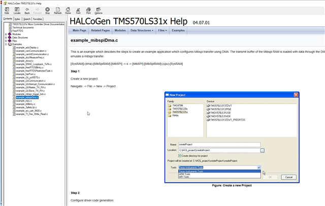

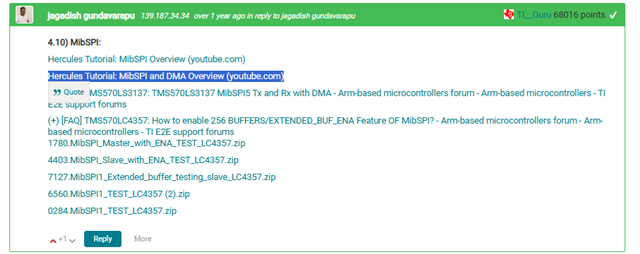

  • Hi Adarsh,
    Thanks for contacting us!
    First i will suggest you to refer below video tutorial on MibSPI DMA:
    (+) [FAQ] TMS570LC4357: Examples and Demos available for Hercules Controllers (E.g. TMS570x, RM57x and RM46x etc) - Arm-based microcontrollers forum - Arm-based microcontrollers - TI E2E support forums
    And also, we do have one MibSPI DMA example in HALCoGen:
    If you refer these two, hopefully this should solve your problem, if not then i will debug your issue further.

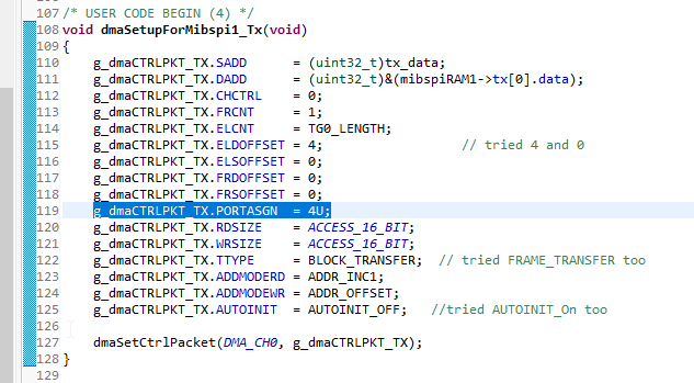

  • Hi Adarsh,
    I don't have exact same board, so i created same example as yours in my TMS570LS3137 board for mibSPI1.
    Here is my working project:
    MibSPI_TX_DMA_LS3137.zip
    Take this as a reference project and do the corresponding modifications on your project.
    On my observation, i am suspecting two main things that could lead to the issue on your end.

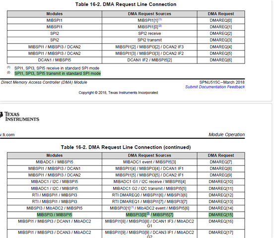

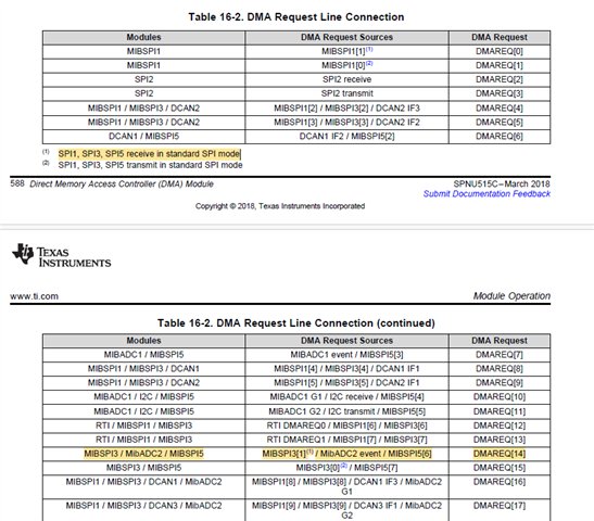

    1. I didn't see port assignment to 4 on your code:
    2. On your code you are using Request line 14 for mibSPI TX right, but this seems like receiving request from TRM:
    So, change it to request line 15 and try:
    So, please try with above modifications and let me know the result.
    Thanks & regards,
    Jagadish.
