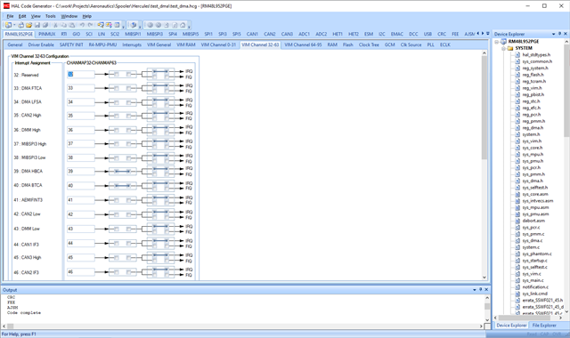

I'm trying to get SPI1 to work with DMA. So far I can't see any bytes transmitted over the MOSI line with scope, only dummy bytes are being transferred when tested, so SPI is supposedly configured correctly.

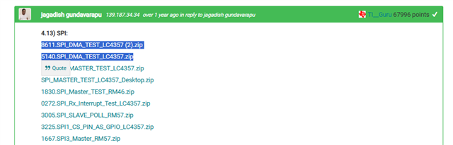

I've tried to use the following sources in order to adapt to RM48L952 MCU with SPI1 (the example is with SPI3 RX):
- Big-endian address : #define SPI1_TX_ADDR ((uint32_t)(&(spiREG1->DAT1)) + 2U)
dmaReqAssign(DMA_CH0, 1); /* Request line 1: SPI1 Transmit */
etc.
Attaching my test code and HALcogen configuration:

#define SPI_DMA_REQ_ENA (1U << 16) // Bit 16 enables DMA request in INT0 register
/* USER CODE END */
/* Include Files */
#include "sys_common.h"
/* USER CODE BEGIN (1) */
#include "spi.h"
#include "sys_dma.h"
uint16_t spi_test_data[8] = {
0x1111, 0x2222, 0x3333, 0x4444,
0xAAAA, 0xBBBB, 0xCCCC, 0xDDDD
unsigned int SPI1_HBCFlag = 0;
unsigned int SPI1_BTCFlag = 0;
g_dmaCTRL g_dmaCTRLPKT_TX;
void dmaConfigCtrlTxPacket(uint32 sadd, uint32 dadd, uint16 dsize, uint16 BlockSize);
/* USER CODE END */
/** @fn void main(void)
* @brief Application main function
* @note This function is empty by default.
* This function is called after startup.
* The user can use this function to implement the application.
/* USER CODE BEGIN (2) */
/* USER CODE END */
int main(void)
/* USER CODE BEGIN (3) */
/* Enable CPU Interrupt through CPSR */
_enable_IRQ();
spiInit();
spiREG1->PC0 = 0
| (1<<11) //SOMI[0] as functional pin
| (1<<10) //SIMO[0] as functional pin
| (1 << 9) //CLK as functional pin
| (0); //CS as GIO pin
spiREG1->PC1 = 0x01; //CS[0] as output
spiREG1->PC3 = 0x00; //CS[0]=0
// spiREG1->FMT0 &= ~(0x1FU);
// spiREG1->FMT0 |= 0x0FU; // 16-bit data
// Enable DMA controller
dmaEnable();
// dmaEnableInterrupt(DMA_CH0, FTC);
dmaEnableInterrupt(DMA_CH0, BTC); //Block transfer complete
dmaEnableInterrupt(DMA_CH0, HBC); //Half block transfer complete
// Map SPI1 TX to DMA CH0
/* Request line 0: SPI1 Receive */
/* Request line 14: SPI3 Receive */
/* Request line 15: SPI3 Transmit */
/* - configuring dma TX control packets */
dmaConfigCtrlTxPacket((unsigned int)&spi_test_data, SPI1_TX_ADDR, 1, sizeof(spi_test_data));
dmaSetCtrlPacket(DMA_CH0, g_dmaCTRLPKT_TX);
// Enable DMA channel
dmaSetChEnable(DMA_CH0, DMA_HW);
// // Enable SPI DMA request generation
spiREG1->GCR1 = (spiREG1->GCR1 & 0xFFFFFFFFU) | (0x1 << 24); //Enable SPI
spiREG1->INT0 = (0x1 << 16); //SPI_DMAREQ; Enable DMA REQ only after setting the SPIEN bit to 1.
// spiREG1->DAT1 = 0x00;
