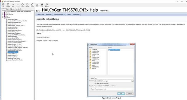

Hello TI Support,
I am working on the TMS570LC4357 LaunchPad and trying to implement MibSPI1 data transmission using DMA. I have followed the TMS570LC43xx TRM (SPNU563A) and example threads on the E2E forums. However, the DMA seems not to transfer data to the MibSPI1 TX RAM. As a result, the data on the MOSI line appears as 0x00 consistently even though logic analyzer shows proper clock pulses.
My Setup:
MibSPI1 Master Mode (No loopback)
DMA TX from memory buffer to mibspiRAM1->tx[x].data
DMA RX from mibspiRAM1->rx[x].data to a memory buffer
TG0 (transfer group 0) configured with 10 elements
DMA channel 0 (RX), channel 1 (TX)
I’ve verified that manually writing to mibspiRAM1->tx[] works as expected, and data appears on the SIMO line
The Problem:
After enabling DMA (via dmaSetChEnable and mibspiTransfer()), the TX RAM of MibSPI1 remains filled with zeroes, indicating DMA did not write data
I’ve verified dmaEnable() is called, correct control packets are configured, and request lines (1 for TX, 0 for RX) are assigned
I tried both DMA_SW and DMA_HW triggering modes for testing
I also tried changing PORTASGN to both PORTA_READ_PORTB_WRITE and PORTB_READ_PORTA_WRITE, adjusting offsets, and toggling AUTOINIT
Despite all this, DMA does not write the data into MibSPI1 TX RAM. The FTC interrupt doesn't fire, and the transferred values are all zero on MOSI.
Request:
Can TI help identify what might be missing or incorrectly configured for DMA to MibSPI1 TX to work on TMS570LC4357?
I have attached my minimal working code here:
