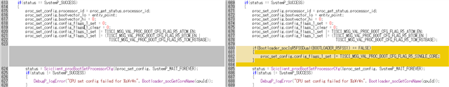

    There is fix in this file of SDK11.1:
    source/drivers/bootloader/soc/am64x_am243x/bootloader_soc.c
    You can see in the picture.
    If customer use AM2432, in SDK 11.1, then they will execute this yellow line, then set the flag |= TISCI_MSG_VAL_PROC_BOOT_FLAG_R5_SINGLE_CORE.
    This is TI AM2432 is not R5FSS0_0 and R5FSS0_1, but RF5SS0_0 and RF5SS1_0.
    But in SDK8.4, the flag is not set, which is wrong.
    Could you please check this and feedback to me, thanks.
    Zekun
  • Hi Zekun,
    If customer use AM2432 and SBL_OSPI, why they do not face this issue?
    As I mentioned in my previous response, SBL OSPI first parses the multicore image (using Bootloader_parseMultiCoreAppImage) and checks which cores are present (using Bootloader_isCorePresent) and only boots the appimages for the core which are present in the multicore image. So, if the multicore image you are booting via SBL_OSPI doesn't have the RPRC for a particular core(r5fss0_1 & r5fss1_1) then it skips booting that core and you don't face any issues.
    This fix was introduced in SDKV8.5 as I mentioned and is also included in the patch I provided, so you will find it in the latest SDK as well.
    Yes, the piece of code highlighted in yellow is checking whether R5FSS1 is in dual core mode or not.
    Meet.
  • Hi  Meet
    One question, if they use SBL_OSPI,  what is the patch need to merge?
    They do not use SBL_NULL.
    Zekun
  • Hi Zekun,
    For SBL_OPSI there is should be no issue, even for SDK V8.4, they don't need to merge any patch.
    Meet.
  • Hi Meet
    That confuse a lot. Because customer use SDK8.4 and SBL_OSPI, boot failed. After merge this, then boot AM2432 successfully.
    Zekun
  • Hi Zekun,
    Okay, let me check if this indeed might be needed for SBL_OSPI and when this was fixed.
    Meet.
  • Apologies for the confusion, so you wouldn't need to make any changes in SBL_OSPI example itself but would still need to change bootloader_soc.c and bootloader_soc.h files, that is why you see SBL_OSPI work correctly only after you have integrated the code highlighted by you in the previous response.
    In any case, any SDK starting from V8.5 and the patch provided by me earlier has the necessary changes needed to fix this issue for AM2432 device.
    Meet.

  • Hi Meet
    For this you will mostly have to integrate the changes from main.c file of SBL_NULL and bootloader_soc.c and bootloader_soc.h file from SDK V8.5, I am providing the patch that fixes only this particular issue:core_variant.patch
    This point should be an error, can you double check and feedback?
    Zekun
  • Yes, It should be
    #define BOOTLOADER_R5FSS0                        (0x00000000U)
    #define BOOTLOADER_R5FSS1                        (0x00010000U)
