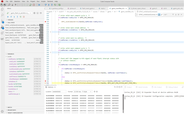

Now we are stuck in the function of GPMC_writeNandCommand() which called by Flash_nandGpmcResetMemory() in flash_nand_gpmc.c
Question
In function GPMC_writeNandCommand(), the GPMC_waitPinInteruptStatusReadyWaitTimeout() always return -1 after calling GPMC_nandCommandWrite(handle,cmdParams->cmdCycle1);
I think that we can't reset memory successfully.
You can see picture for more information.
Command Register : 0x4840007C and Address Register : 0x48400080
The cmdParams->cmdCycle1 is 0xFF

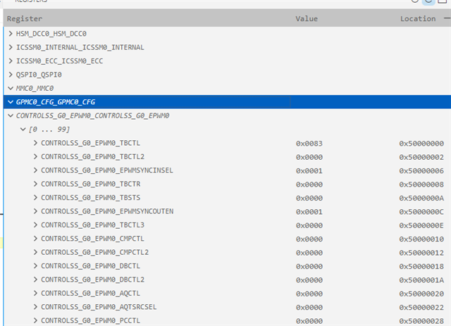

    Could you also provide the dump of all the GPMC registers using CCS register view (Right click and export to text file):
    Sahana
  • 1 Unfortunately, we can't open GPMC and MMC Registers and others can be opened. I don't know the reason. You can see below picture. Also, There is no selection after Right click.

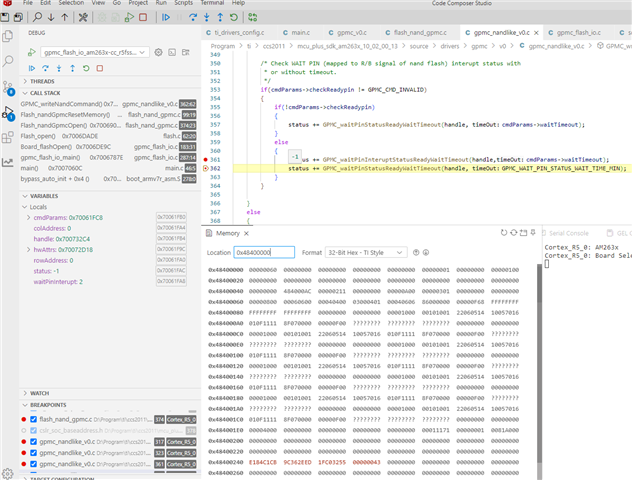

    2 I think we can get register value from Memory view. You can also see below picture. The value is 0x0000,0211 at address 0x48400048. It seems that the error is due to a non supported address.
    3 About CS Base Address : In am243x demo, the base address is 0x5000,0000. It's a FSS Memory Regions. But There is not same region in am263x. We address is 0x6800,0000 in our project.
    4 About Input Clock Frequency : The frequency is now 0x1000,0000. Is it right? Where can we get the right value. As this value is 1333,3333 in am243x demo. But it can' work when we set 1333,3333 in our am263x project.

  • Unfortunately, we can't open GPMC and MMC Registers and others can be opened. I don't know the reason. You can see below picture. Also, There is no selection after Right click.
    You'll need to check for software updates in CCS in order to see this. Click on Help -> Check for updates and perform the updates. You'll then be able to see the registers.  I'll be able to confirm the timing values with the help of these registers.

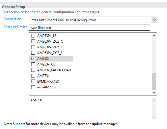

  • You'll need to check for software updates in CCS in order to see this. Click on Help -> Check for updates and perform the updates. You'll then be able to see the registers.  I'll be able to confirm the timing values with the help of these registers.
    Also ensure to use "AM263x" in the target configuration ccxml file, and not AM2634/AM2632 or any other:

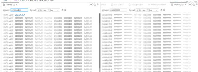

  • Hello Sahana, Now I can write and read nand flash successfully. And read content is consistent with the written content.
    But how can I see the written content in memory? I checked the address 0x6820,0000(base+offset) in debug session and the value is 0xFF.
    You can see below picture. The left is written content in RAM.
  • Hi Wei Yao,
    Are you using the API "GPMC_nandReadData" to perform the read? Also ensure that DMA is not being used to perform the read, as it has not been configured in the project.
    Following is the current configuration in the project, so you would only be able to read 16MB at a time with the start address 0x68000000. You could also modify the chip select size to 128MB to map to the entire GPMC Data size available (0x68000000 - 0x6FFFFFFF)
