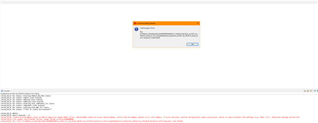

    but I still encounter a JTAG error:
    Cortex_R5_0: Trouble Writing Memory Block at 0x0 on Page 0 of Length 0x40: (Error -1065 @ 0x40) Unable to access device memory. Verify that the memory address is in valid memory. If error persists, confirm configuration, power-cycle board, and/or try more reliable JTAG settings (e.g. lower TCLK). (Emulation package 20.0.0.3178) Cortex_R5_0: File Loader: Verification failed: Target failed to write 0x00000000 Cortex_R5_0: GEL: File: B:\Robert_Li\OneDrive\Root\ARG8000\AM2612_Code\rti_led_blink_am261x-lp_r5fss0-0_nortos_ti-arm-clang\Release\rti_led_blink_am261x-lp_r5fss0-0_nortos_ti-arm-clang.out: Load failed.

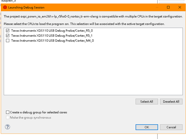

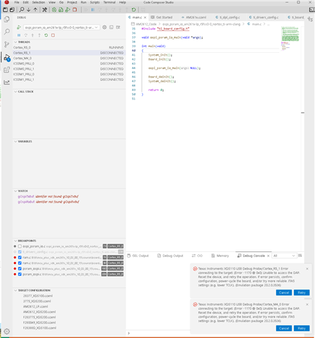

  • Dear Nilabh,
    I found the issue. The root cause of the DAP error is that the core cannot be read. I discovered that the M4 core cannot be accessed, so unchecking this option before starting allows debugging to proceed. I tried the same situation on CCS20, and the R1 core could not be read. Thank you.
