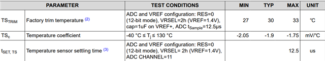

I am sampling the temperature sensor on the MSPM0G1507 and I am having some issues when converting the ADC reading to a temperature. My ADC values on ADC0 channel 11 (Temperature Sensor) are around 1760 at room temperature. The trim value read from the factory region is 796. When I make the calculation, I get this result:
Parameters
  • Sampling Time = 25 us
  • TEMP_SENSE0 = 796
  • TSC = -1.8 mV/℃ (From slasew9d)
  • TSTRIM = 30 ℃ (From slasew9d)
  • VREF = 1.4 V
  • VREF_TRIM = 1.4 V (From slasew9d)
  • RES = 12 bits
VSAMPLE = (1.4 / 4096) * (1760 - 0.5) ≈ 0. 6014 V
VTRIM = (1.4 / 4096) * (796 - 0.5) ≈ 0. 2719 V
TSAMPLE = (1000 / -1.8) * (0.6014 - 0.2719) ≈ -183.1 ℃
TRM’s (slau846b) example trim value of 1857 provides a more realistic result:
VTRIM = (1.4 / 4096) * (1857 - 0.5) ≈ 0.6345 V
TSAMPLE = (1000 / -1.8) * (0.6014 - 0.6345) + 30 ≈ 48.39 ℃
These are the values read from the factory region:
TRACEID: 0x001D1D35
DEVICEID: 0x2BB8802F
USERID: 0x804D2655
TEMP_SENSE0: 0x0000031B
I also tested on another board to see if it was a single flawed calibration value, but I read 795 from the TEMP_SENSE0 register. This part is being used on a custom board.
Similar questions seemed to be using early samples, as identified by an empty TRACEID, but this is not the case for my part.
