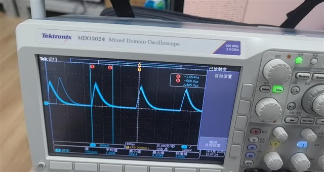

If the timer is started before the task is created, the output period of the DAC module is stable, as shown in Figure 1.

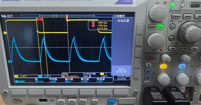

Why is the output period of the DAC module unstable when the timer is started after task creation, as shown in Figure 2.
What could be the reason?

    I suppose you use an external DAC. A DAC peripheral is not available in the AM2434 according to the SoC documentation.
    1. Which hardware interface does the AM2434 use to communicate with the external DAC ?
    I am looking at the Task1 code and as a hardware application engineer try to understand the hardware behavior according to the waveforms you obtained:
    2. I think 200 us rising time to reach from 0V to 5V, would be too slow a settling time for a DAC output.
    And I referred this example thread on some typical DAC output settling time:
    DAC output parameters example
    I see no flat 5V segment visible in the output curve. It seems to me that you either have some filter capacitor attached at the DAC output or you placed the probe at another circuit point different than the DAC output. Can you clarify ?
    3. Would it be possible to provide a schematic of your measurement setup ?
    Regarding your main concern, I can see the Timer 3 generated period (duration from DAC output at 0V through the next time DAC output starts from 0V) is approximately 1 ms.  On the second waveform I can see it varies +-200 us in length, as per your concerns.
