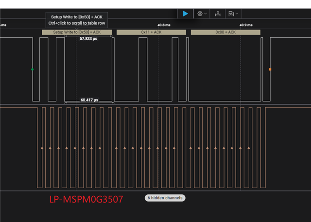

I successfully developed and tested an I2C firmware on the LP-MSPM0G3507 LaunchPad1. The I2C communication (using I2C0: PA0 as SDA, PA1 as SCL) works correctly, writing to two different ICs without any issues.

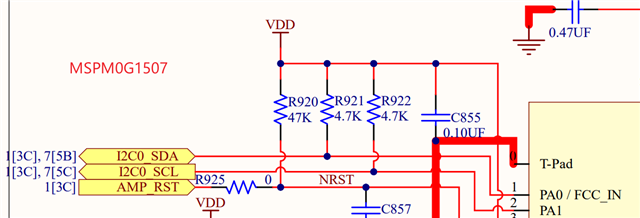

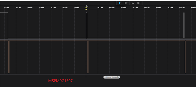

However, when I flash the exact same firmware onto a custom board featuring the MSPM0G1507 microcontroller, the I2C communication fails to work entirely.
To help diagnose the problem, I’ve confirmed the following:
Hardware Connections: The SDA and SCL lines are properly connected with appropriate pull-up resistors (e.g., 4.7kΩ for 400kHz communication as a reference, though I'm running at a lower speed).

    And could you also check the schematic around PB8 in customer's board? To see whether there is any circuit pull the PB8 to low in schematic or layout.
