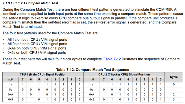

By “inputs,” I was referring to the test patterns or data values that are provided to both cores (which are in lockstep) during the CCM self-test example. I wanted to understand if these patterns can be modified (for example, changing the operand values or operations being compared between Core0 and Core1) to check how the CCM detects mismatches.
That is not configurable by the user, please see chapter "R5FSS Lockstep Compare" in the device TRM AM263x Sitara Microcontroller Technical Reference Manual (Rev. I) to understand more about CCM. The following 4 test patterns are generated by the CCM module as present in the TRM:

I understood the test cases. Is there any other way to test the safety feature of lockstep mode.
Sravanthi R.
No, CCM is the only way to test the lockstep safety feature on R5F Subsystem.

So we can test Lockstep feature using CCM only. And the test cases for CCM is also fixed right?
