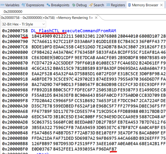

    Thanks for help. It's requirement of bootloader. The flash driver code which must be saved into a single file must be download to RAM.
    I find DL_FlashCTL_executeCommandFromRAM() is in address 0x20000758 when it's in debug state.
    The save RAM content to a file operation: Right click and select 'Save Memory' with special address and length, then to required file type. I have done this. If you have another method please share me.
    My question now are:
    1, Does function DL_FlashCTL_executeCommandFromRAM() is the only flash drive code which is run in RAM?
    2, Is the code of DL_FlashCTL_executeCommandFromRAM() with address 0x20000758 to 0x20000BFF (The address is from Memory Browse in debug state)? In my opinion it's a little big.
    3, The function DL_FlashCTL_executeCommandFromRAM() is included in code now. How to exclude generated content of this function?
        Does it ok with comment the code in DL_FlashCTL_executeCommandFromRAM(), and download same comment of below picture into address 0x20000758?

    The code of DL_FlashCTL_executeCommandFromRAM() between address 0x20000758 and 0x20000BFF (The address is from Memory Browse in debug state, see below picture).
    The content of DL_FlashCTL_executeCommandFromRAM() is still included in RAM after the content in function is commented out (the same as below picture).

    I'm not sure why the function isn't clearing from that region of memory. It's possible that if you have calls to FromRAM DriverLib functions, which all call the DL_FlashCTL_executeCommandFromRAM() function.
    Does your LIN data have to be between 0x20000758 and 0x20000BFF? I would suggest storing the LIN data at a different address if possible. You can adjust the linker file to allocate regions of memory for this. In code you can also just use a pointer instead of specifying a RAM address.

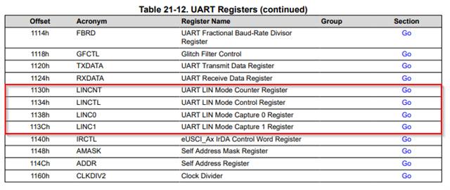

  • Hi Bian,
    The LIN data is stored in the peripheral registers, not Flash or RAM. In the Technical Reference Manual, it is stated that this region begins at 0x4000.0000:
    In the UART Registers table:
    You can also reference the SDK examples lin_commander and lin_responder for implementation.
    Is this what you are looking for?
    Owen

    I want to do like below steps:
    1, The RAM address of DL_FlashCTL_executeCommandFromRAM() is between 0x20000758 and 0x20000BFF in current code. Then save the content of whole address into 'flashdrv.hex'.
    2, Next i comment the content in DL_FlashCTL_executeCommandFromRAM() and complier pass
    3, Next download 'flashdrv.hex' into RAM address 0x20000758 and 0x20000BFF.
    Is there any risk with upper operation? If yes, please give your suggestion. Thanks!

  • Hi Bian,
    I'm not sure if I'm understanding the steps, but here's how I am interpreting this.
    • You want to save the DL_FlashCTL_executeCommandFromRAM() function as a hex file?
    • Why are you commenting out the implementation of the function? This will compile but the code will not execute as expected.
    • You want to put the code back into the address?
    • What is the idea behind doing this?
    It seems to me that you are trying to remove something just to put it back in the same place?
    Owen
  • Hi Owen,
    • You want to save the DL_FlashCTL_executeCommandFromRAM() function as a hex file? yes
    • Why are you commenting out the implementation of the function?  yes. This will compile but the code will not execute as expected.
    • You want to put the code back into the address? Yes, The code will execute same as DL_FlashCTL_executeCommandFromRAM() comment before.
    • What is the idea behind doing this?  It's customer requirement. the flash driver must be download into RAM when app code need reflash.
    • It seems to me that you are trying to remove something just to put it back in the same place?  yes
  • Hi Bian,
    Thanks for clarifying. I think I am starting to understand now.
    Are you trying to run a flash loader from RAM?
    I came across this E2E thread that goes over running in RAM. Is this helpful?
    Since the compiler doesn't naturally put code into RAM, I think you could also update the linker file to do this, however this is something I'd need to look into. You may even be able to load your program into flash, generate the hex, and load that hex into RAM, but there may be some addressing risks since it would be running in different location than it was built for.
