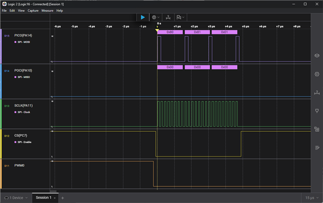

  • With Motorola 4 wire protocol with 8 bit data length , writing three bytes back-to-back into Tx FIFO generates correct CS control for 24 clocks:
    TRM seems to be implying that it is not how it should be.
    Does Motorola 4 wire CS control work around the whole FIFO until it exhausted according to performed number of writes?

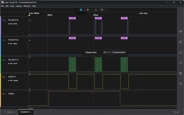

    It is standard Motorola 4 wire with auto-CS control. Not sure if clock phase control has anything to do with it. The question is the behavior of CS in 4 wire configuration as it is related to TX FIFO. It seems that if there is enough time between writes to TXDATA to shift bits out then CS is toggled around individual bits per DSS. When there is not enough time to shift between writes then all values in TX FIFO are surrounded by CS. See this picture as compared to previous one.
    This is not mentioned anywhere in the TRM and is interesting behavior of the SPI peripheral. One would assume that CS control is around DSS bit count but that is not the case and depends on timing of the writes to TXDATA?
    Is there a configuration I am missing? Would IFLS have anything to do with it?
  • TRM (SLAU846C) Sec 25.2.3.1, in the subsection "Motorola SPI Frame Format with SPO = 0 and SPH = 1" says: "For continuous back-to-back transfers, the CS pin is held low between successive data words". Quoting myself from the thread I referenced above: "based on context and history I interpret [continuous back-to-back] as "the Tx FIFO (+ shift register) never empties"." The SPI unit has no concept of a "transaction" so it has no way of knowing which byte is the final one; instead it "guesses" based on the (Tx) data stream going idle.
    The corresponding paragraph in the subsection "Motorola SPI Frame Format with SPO = 0 and SPH = 0" says: "For continuous back-to-back transmissions, the CS signal must pulse high between each data word transfer because the peripheral-select pin freezes the data in its serial peripheral register and does not allow altering of the data if the SPH bit is clear." This is the distinction based on SPH.
