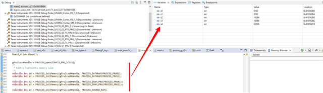

ICSS_G1_PRU_0: File Loader: Verification failed: Values at address 0x0000000D@Data_Memory do not match Please verify target memory and memory map.
ICSS_G1_PRU_0: GEL: File: C:\working\dd3s_workspace\test_c\Debug\test_c.out: a data verification error occurred, file load failed.
I loaded the same (!) binary into am5726 (!) without any problem.
    The side loading feature is supported by AM243x as well, but it needs the PRU clocks to be setup before the .out file can be loaded onto it. We can enable this by having some example running on R5 core which initializes the PRU clocks. For that, you might have to add PRU IO module in syscfg in the example you are running in R5 core. Another option is to enable PRU in the DMSC core.

    We use ind_comms_sdk_am243x_09_01_00_03.
    Here is part of main,
    int main(void)
    /* init SOC specific modules */
    System_init();
    Board_init();
    Drivers_open();
    Board_driversOpen();
    gPruIcss0Handle = PRUICSS_open(CONFIG_PRU_ICSS1);
    * Each s represents memory size
    volatile int s0 = PRUICSS_initMemory(gPruIcss0Handle, PRUICSS_DATARAM(PRUICSS_PRU0));
    volatile int s1 = PRUICSS_initMemory(gPruIcss0Handle, PRUICSS_DATARAM(PRUICSS_PRU1));
    volatile int s2 = PRUICSS_initMemory(gPruIcss0Handle, PRUICSS_IRAM_PRU(PRUICSS_PRU0));
    volatile int s3 = PRUICSS_initMemory(gPruIcss0Handle, PRUICSS_IRAM_PRU(PRUICSS_PRU1));
    volatile int s4 = PRUICSS_initMemory(gPruIcss0Handle, PRUICSS_SHARED_RAM);
    I tried to add PRU GPIO into sysconfig. It did not help.
    Other thoughts ?
    Rasty

    Commented by mistake I'll use stack in the future.
    Meanwhile the problem is mismatch at address 0x19. As Shown at the picture, Please help me to undertand why debugger complains about mismatch.
