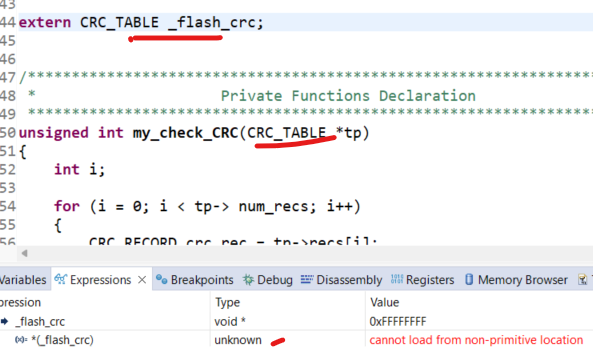

I want to implement CRC calculation and store result in HEX file with updated .cmd file. Then read out CRC result in C code.
I change content in .cmd file, see red in first picture. The CRC content _flash_crc is in .map file, see red in second picture.
But _flash_crc does not have content in debug state, see third picture.
I reference chapter 10.9 of complier user manual. Is there other references? thanks

  • Hi Bian,
    Ok, again, sorry for the delay.
    Looking back through your code I see the CRC_TABLE, which should come crc_tbl.h, so not exactly sure why the CCS can't display _flash_crc as a struct as I did in my example I put together (see below). You can see the _flash_crc_table in the expressions window. IDE.
    Just a note -> In the linker cmd file you shouldn't use type=copy as this prevents the CRC from being placed in memory
    Do this instead
    Check out the attached pdf, slide 4 for a complete view of my CCS if that helps.  Let me know ... I can post my code also.

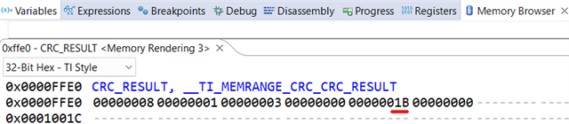

  • Hi Dennis,
    Thanks for your so detail explain. I comment 'type = COPY' in .cmd, so the result of MEMRANGE_CRC_TABLE in expressions window. IDE now.
    But the value is wrong.
    BTW, I use CCS 12.4, CLANG 4.0.1
