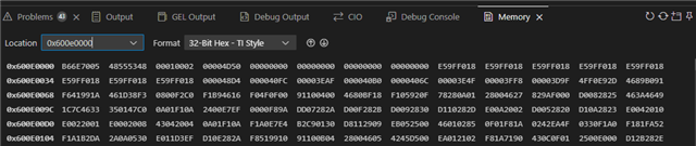

  • The current issue is that we are not switching into 4-byte mode some of the time. I have one control card that works fine 80% of the time, and another control card (same revision) that never boots even when both are running the exact same image from boot. before I post specifics, I would like to make it clear that this is just the most recent issue we are facing as we continue to play whack-a-mole with seemingly random issues.
    We can see that when then board boots as expected, we are able to connect to R5_0 and read memory region 0x600E0000 and see:

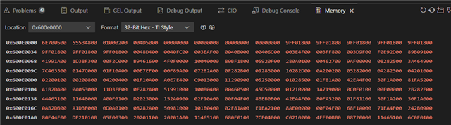

    On the board that never boots correctly, when we view memory region 0x600E0000, we can clearly see that we are only getting 3 of 4 bytes:
    We have validated all switch settings. and we have used UniFlash to validate that the contents at address 0x600E0000 appear as expected after programming (all 4 bytes present from both control cards).

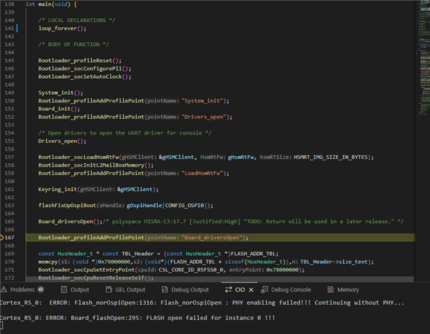

    When I add in the loop_forever function to the SBL then connect in CCS to step through the boot on the failing control card, I see the following:
    Please note that we have slowly rolled back modifications to TI's example code in an effort to stabilize things. The functions called throughout this pictured main code have not been modified from the sbl_ospi example from SDK 10_02_00_15.

  • A very interesting observation. While using the consistently failing control card, I loaded the unaltered build from the sbl_ospi example with loop_forever enabled and walked through the main function until I reached the Bootloader_profileAddProfilePoint("Board_driversOpen") call. In this instance, I did not get any indication that the PHY had failed to initialized (as shown above in this thread).
    After that, I re-loaded our custom SBL onto that same control card and walked through the code to that same point in code. This time, I did not receive the error regarding failure to correctly enable the PHY. I am also now able to see the contents of memory address 0x600E0000 correctly (all 4 bytes instead of 3).
    So, I believe may be onto something with the PHY not being started correctly. However, I have not been able to determine where in SysConfig or custom code where there is a difference on the PHY from our custom SBL to the sbl_ospi example.
