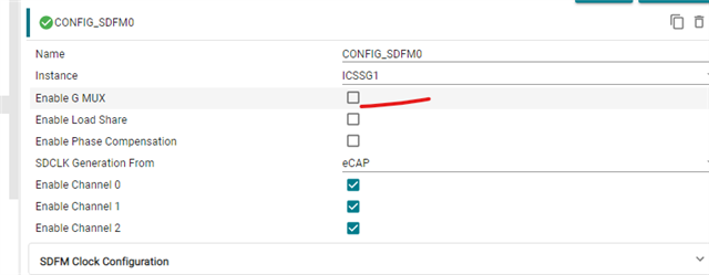

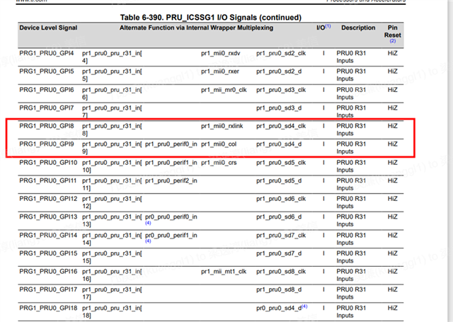

Customer schematic design is PRG1_PRU0_GPO9 for SD4 sampling, but the sysconfig configuration can only be configured to GPO18. How to configure directly from sysconfig to GPO9 (Note: The manual says to change one of the registers ICSSG_SA_MX_REG(7)G_MUX_EN=1, but sysconfig did not find any changes)
