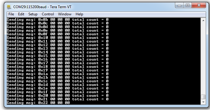

  • int main(void) { tCANMsgObject sCANMessage; unsigned char ucMsgData[4]; // // Set the clocking to run directly from the external crystal/oscillator. // TODO: The SYSCTL_XTAL_ value must be changed to match the value of the // crystal on your board. // SysCtlClockSet(SYSCTL_SYSDIV_1 | SYSCTL_USE_OSC | SYSCTL_OSC_MAIN | SYSCTL_XTAL_16MHZ); // // Set up the serial console to use for displaying messages. This is // just for this example program and is not needed for CAN operation. // InitConsole(); // // For this example CAN0 is used with RX and TX pins on port D0 and D1. // The actual port and pins used may be different on your part, consult // the data sheet for more information. // GPIO port D needs to be enabled so these pins can be used. // TODO: change this to whichever GPIO port you are using // SysCtlPeripheralEnable(SYSCTL_PERIPH_GPIOB); // // Configure the GPIO pin muxing to select CAN0 functions for these pins. // This step selects which alternate function is available for these pins. // This is necessary if your part supports GPIO pin function muxing. // Consult the data sheet to see which functions are allocated per pin. // TODO: change this to select the port/pin you are using // GPIOPinConfigure(GPIO_PB4_CAN0RX); GPIOPinConfigure(GPIO_PB5_CAN0TX); // // Enable the alternate function on the GPIO pins. The above step selects // which alternate function is available. This step actually enables the // alternate function instead of GPIO for these pins. // TODO: change this to match the port/pin you are using // GPIOPinTypeCAN(GPIO_PORTB_BASE, GPIO_PIN_4 | GPIO_PIN_5); // // The GPIO port and pins have been set up for CAN. The CAN peripheral // must be enabled. // SysCtlPeripheralEnable(SYSCTL_PERIPH_CAN0); // // Initialize the CAN controller // CANInit(CAN0_BASE); // // Set up the bit rate for the CAN bus. This function sets up the CAN // bus timing for a nominal configuration. You can achieve more control // over the CAN bus timing by using the function CANBitTimingSet() instead // of this one, if needed. // In this example, the CAN bus is set to 500 kHz. In the function below, // the call to SysCtlClockGet() is used to determine the clock rate that // is used for clocking the CAN peripheral. This can be replaced with a // fixed value if you know the value of the system clock, saving the extra // function call. For some parts, the CAN peripheral is clocked by a fixed // 8 MHz regardless of the system clock in which case the call to // SysCtlClockGet() should be replaced with 8000000. Consult the data // sheet for more information about CAN peripheral clocking. // CANBitRateSet(CAN0_BASE, SysCtlClockGet(), 500000); // // Enable interrupts on the CAN peripheral. This example uses static // allocation of interrupt handlers which means the name of the handler // is in the vector table of startup code. If you want to use dynamic // allocation of the vector table, then you must also call CANIntRegister() // here. // // CANIntRegister(CAN0_BASE, CANIntHandler); // if using dynamic vectors // CANIntEnable(CAN0_BASE, CAN_INT_MASTER | CAN_INT_ERROR | CAN_INT_STATUS); // // Enable the CAN interrupt on the processor (NVIC). // IntEnable(INT_CAN0); // // Enable the CAN for operation. // CANEnable(CAN0_BASE); // // Initialize the message object that will be used for sending CAN // messages. The message will be 4 bytes that will contain an incrementing // value. Initially it will be set to 0. // *(unsigned long *)ucMsgData = 0; sCANMessage.ulMsgID = 0x500; // CAN message ID - use 1 sCANMessage.ulMsgIDMask = 0; // no mask needed for TX sCANMessage.ulFlags = MSG_OBJ_TX_INT_ENABLE; // enable interrupt on TX sCANMessage.ulMsgLen = sizeof(ucMsgData); // size of message is 4 sCANMessage.pucMsgData = ucMsgData; // ptr to message content // // Enter loop to send messages. A new message will be sent once per // second. The 4 bytes of message content will be treated as an unsigned // long and incremented by one each time. // for(;;) { // // Print a message to the console showing the message count and the // contents of the message being sent. // UARTprintf("Sending msg: 0x%02X %02X %02X %02X", ucMsgData[0], ucMsgData[1], ucMsgData[2], ucMsgData[3]); // // Send the CAN message using object number 1 (not the same thing as // CAN ID, which is also 1 in this example). This function will cause // the message to be transmitted right away. // CANMessageSet(CAN0_BASE, 1, &sCANMessage, MSG_OBJ_TYPE_TX); // // Now wait 1 second before continuing // SimpleDelay(); // // Check the error flag to see if errors occurred // if(g_bErrFlag) { UARTprintf(" error - cable connected?\n"); } else { // // If no errors then print the count of message sent // UARTprintf(" total count = %u\n", g_ulMsgCount); } // // Increment the value in the message data. // // (*(unsigned long *)ucMsgData)++; (*(unsigned long *)ucMsgData)= (*(unsigned long *)ucMsgData)+10; } // // Return no errors // return(0);
    With the above code i am not able to see tx output in oscilloscope. Rx is connected with 3.3V
    Any idea why i am not able to see the wave form in osicilloscope?

                  For the above code i am not able to see the g_ulMsgCount counter getting incremented which confirms that no interrupt has occurred for successful transmission.I have attached the screen shot of data received in Hyper terminal.
    As you said i have checked the voltage values across the transceiver which is as follows:
                   1)TX(D): 2.87v(With respect to GND)
                    2)RX(R):3.28v(With respect to GND)
                   3)CANH: 2.27v(With respect to GND)
                   4)CANL: 2.27v(With respect to GND)
    I have attached the connection details of how the CAN transceiver is connected to LM4F232H5QD.
    Can you pls confirm the connection & let me know why the counter is not getting incremented. Connection Diagram.docx
    Nitin

  • Hi Sue,
    Can you pls tell how to check whether my PB4 & PB5 pin are configured fine as CAN0 without using the transceiver.As when i send 8 bytes of data(i.e ucMsgData[4]= {0xAA,0x55,0xAA,0x55,0xAA,0x55,0xAA,0x55};) i am not able to see any voltage changes in the CANTX pin.I have tried in both Tiva launchpad & LM4F232 evaluation board.
  • Hello Nitin,
    Should'nt the line
    GPIOPinTypeCAN(GPIO_PORTB_BASE, GPIO_PIN_0 | GPIO_PIN_1);
    be changed to
    Did you already try this?
    Sai
  • Hi Sai,
               Thank for your quick response..
               That was one of the reason, now i am able get voltage at CAN0TX(PB5 pin) i.e 1.75v but it stays at that voltage form some time and returns back to 3.3v whether this is due to busoff condition as in my setup i only have single micro & transceiver.
    I am not able to receive any transmit interrupt after the data has been transmitted form TX line wat might be the reason??
    OR
    whether we need to have two Micro & two transceiver to get the transmit interrupt.
    Nitin
