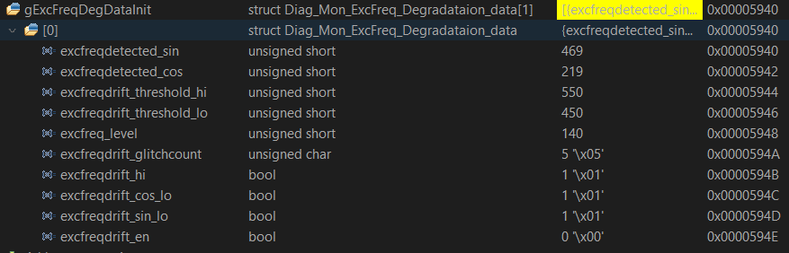

I have single mode resolver in RDC_SEQUENCER_MODE_0 which is generating 5KHz excitation at excitation frequency amplitude of 140. There are two faults that I am not able to figure out how to clear.
  1. Excitation Frequency Degradation Diagnostics sin and cos counts are toggling between 218/219 to 469, while expected count is suppose to be between 450 and 550. I see in oscilloscope that zero crossing for sin and cos is occuring at 5KHz but still this fault is not clearing.
    2. Sine/Cosine Gain Drift and Cosine Phase Drift fault is triggered when going is positive direction but cleared in negative direction of speed.

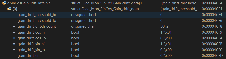

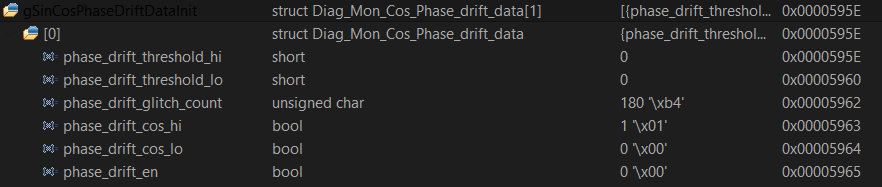

    Also, I have observed that gain_drift_threshold_hi, gain_drift_threshold_low, phase_drift_cos_hi and phase_drift_cos_lo are cleared while calling their individual set functions RDC_setDiagnosticsSinCosGainDriftData and RDC_setDiagnosticsCosPhaseDriftData. I am not sure if this is intentional or something that might have been fixed in other versions of SDK.
    So, question I have is how can I clear the above-mentioned faults?

    Can you try setting the excfreq_level threshold to a lower value and check once, since you mentioned Excitation frequency has an amplitude of 140? Two more checks I can think of is
    • If possible, can you please probe the actual signals and see if you are able to see the zero crossings in the Cosine signal?
    • Also, since you mentioned of using Mode 0, can you please cross verify if the Cosine signals are correctly connected to ADC_R1_AIN0 and ADC_R1_AIN1 pins as shown in the Figure 7-140. Mode -0 of AM263Px Sitara Microcontrollers Technical Reference Manual (Rev. D).
    The `excfreq_level` needs to be higher than noise margin, like Tejas mentioned, could you please try with a higher value like 255 or 300 ?
    We identified that the writes are happening in the set functions for phaseGain related diagnostics at incorrect register offset. we get this corrected in the later releases. This could also resolve incorrect flag setting up in your case.

    I used 300 for excfreq_level and recorded excfreqdetected_sin in graph as shown below. I see the values of excfreqdetected_sin go in and out of threshold limits, but fault does not clear. Also modifying the excfreq_drift_threshold_lo / hi completely changes the feedback and I start getting random values for excfreqdetected_sin. In my understanding threshold is for checking sin/cos are within defined threshold and should be changeable based on my feedback on excitation signal. Like in below example if I change my threshold to be 350 and 450 then my sin feedback is ranging from 12 to 120 to 200 which is very confusing.
    Apart from this I have seen that changing excfreq_level changed signal integrity sinsq and cossq values. I could be delusional here but just looking for more help as now signal integrity checks are failing.
  • Hi Harveen,
    The excfreqdetected_cos/sin counts should never have been under threashold, if so, its a fault and would have flagged the error flag. the counts is a runtime counter data, having a CCS graph (slower graphing) will not help understand its behavior. what do you mean by feedback?

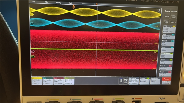

    The only observation I have is excitation amplitude is changing from 8.4Vpp to 1Vpp which is causing my sin cos feedback to scale as well. I do not remember seeing this issue when I was debugging the resolver setup previously. I have checked all my wires and none of them are touching.
    /cfs-file/__key/communityserver-discussions-components-files/908/Excitation-Amplitude-Changing-Jan20_2C00_-2026.zip
  • Tejas, The issue mentioned previously was due to sampling rate of oscilloscope. Here are the new screenshots where excitation frequency Vpp is constant.
    In the above screenshots, channel 1 is Sin AM, channel 2 is Cos AM, channel 3 is excitation freq and channel 4 is TP20 on control card.
  • Hi Harveen,
    Apologies for the late reply.
    Just few observations below
    1. Both the Sin and Cosine waveforms when with maximum amplitude have Peak-to-Peak voltage of around 4V?
    2. The Channel 1 Sine seems to have correct Sine wave lowest point to be at Zero, but the lowest point of Cosine is less than Zero(shown the same marked in red in below waveform)
    3. The above two points seem to violate the absolute maximum rating of the ADC_R pins. I am surprised how the voltage is going above 3.3V and below 0V since the schematics you shared over email has it clipped between A_3V3 and S_0V.
      1. These voltage range have to be fixed, not sure what would be the result of input waveforms going out of range of 3.3V and 0V.
      2. For debugging now, maybe we can try reducing the Excitation frequency amplitude, which would result in corresponding reduction in amplitude of Sine and Cosine inputs, to bring them within range.
    Also is this on your custom board, or the Control Card? Meaning do these waveforms correspond to the schematics you shared over email, or is it connected directly to AM263P-Control Card now? Apologies I am confused on this.
    Tejas Kulakarni
