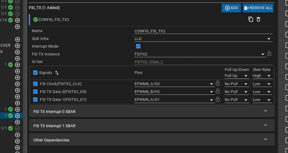

My guess is that this is a pinmux issue since loopback mode bypasses the pinmux; however, I can't seem to find anything wrong with my setup. FSI signals are muxed with MCAN signals, but FSI is default because of the pull-up resistor on FSI_MUX_SEL. By the way, this documentation is incorrect (the pull-down resistor is not populated):
The MCAN signals go through a 1:2 signal routing mux. There is a pull-down resistor on the select line of the mux and therefore the MCAN signal routing is the default.
I am also fairly certain that my AM263 Pinmux is setup correctly.  From the PROC1592E2 schematic:
FSIRX2_CLK J2
FSIRX2_DATA0 G4
FSIRX2_DATA1  J3
FSITX2_CLK G3
FSITX2_DATA0 H2
FSITX2_DATA1 G1
Sysconfig setup:

  • I'm having the same issue as Jared. This can be duplicated easily using an AM263P4 control card (mine is revision PROC159B(001)) and MCU+ SDK v11.00.00.19.
    Load example "FSI Loopback Interrupt". Make the following changes:
    1. In sysconfig, change FSI TX and RX pinmux to match the AM263P4 control card (RX_CLK = ball J2, RX_DATA0 = ball G4, TX_CLK = ball G3, TX_DATA0 = ball H2)
    2. In file fsi_loopback_interrupt.c replace "FSI_enableRxInternalLoopback" with "FSI_disableRxInternalLoopback"
    3. On the ControlCard, use shunt jumpers to short TX CLK to RX CLK (pin 1 to 2) and TX DATA0 to RX DATA0 (pin 5 to 6) on header J6.
    With those changes I see the same result as Jared, which appears like FSI RX2 isn't receiving. Using an oscilloscope I see TX clock and data on J6 pins 2 and 6, and the example runs successfully in loopback mode. But when loopback is disabled the program hangs forever waiting for an RX interrupt.
  • Hi Jared, Steven,
    First, I will confirm what you have already stated, just so there is no confusion:
    1. The MUX U33 selects between the routing of the MCAN or FSI signals to their respective interfaces. FSI is selected by default, as the pull-up resistor R204 routes the A->B2 ports of the mux.
      1. However, the initial revision of this board, Rev E1 had the opposite of this, where the pull-down resistor was populated by default. It is worth checking the SysConfig settings for the IO Expander that controls the select signal of this mux to ensure that it is being pulled HIGH in software as well:
    2. Verifying the MCU PinMux:
      1. Signal MCU Pin
        FSIRX2_CLK J2
        FSIRX2_DATA0 G4
        FSIRX2_DATA1 J3
        FSITX2_CLK G3
        FSITX2_DATA0 H2
        FSITX2_DATA1 G1
      2. This all looks fine in your SysConfig screenshots that you sent.
    Please confirm the MUX SEL configuration in SysConfig to rule out any issues with the MCU PinMux or board-level signal configuration.

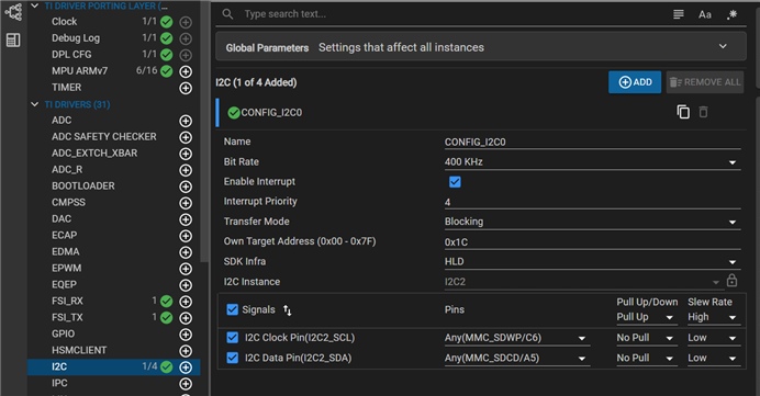

  • Hey Brennan,
    Thanks for getting back to me on this. I verified that correct pull-up resistor is populated; however, we setting the FSI mux selected in software via sysconfig. I attempted to update sysconfig with the correct FSI mux select, but the code is now hanging on I2C_transfer(). I assume this is due to improper I2C setup in sysconfig.
    Do you see any issues with my sysconfig setup?
    Thanks for your help,
    Jared
  • Jared,
    I2C2 is the I2C peripheral that is connected to the IO Expander. You need to configure:
    • I2C2_SCL on C7
    • I2C2_SDA on B7
    Let me know if the I2C transfer now goes through.
    Brennan
  • Still seems to be hanging on the I2C transfer after the changes.
