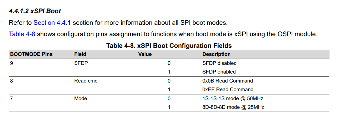

    For an xSPI boot mode:
    Let's look at the below table in Chapter, Initialization /  Section, Boot Modes / Section, xSPI Boot of the AM243x TRM.:
    I found out that the ROM supported command 0xEE for a fast read in 8D-8D-8D is not available in the IS25WX064-JHLE documentation, therefore it is unsupported by this flash memory.  This means that a xSPI boot with  BOOTMODE9=0b0, BOOTMODE8=0b1, BOOTMODE7=0b1 is unsupported by the Flash memory.
    A xSPI boot with  BOOTMODE9=0b0, BOOTMODE8=0b0, BOOTMODE7=0b0 is supported by the Flash memory in 1S-1S-1S at OSPI0_CLK freq= 50 MHz
    Both the AM243x ROM and  IS25WX064-JHLE flash memory are SFDP compatible, meaning they both support the SFDP feature as per JEDEC JESD216. So with BOOTMODE9=0b1, BOOTMODE8 = don't care, BOTMODE7=don't care you can achieve a ROM xSPI boot that starts in traditional SPI boot mode: 1S-1S-1S at OSPI0_CLK freq= 50 MHz  and a subsequent switch via SFDP header learned command to a DDR 8D-8D-8D booting but with ROM limited OSPI_CLK freq = 25 MHz.
    Last but not least, for your IS25WX064-JHLE Flash memory the XiP (execute-in-place) feature is supported in the xSPI operation mode of the memory.
    Le me know If you need to execute a bootloader fro FLASH during AM243x ROM boot, I need a confirmation from an AM243x ROM expert if the XiP enable/operation commands specific for the IS25WX064-JHLE are supported by the ROM bootloader.
    I understand that enabling of xSPI mode for IS25WX064-JHLE can allow XiP execution of code from the OSPI Flash memory (instead of load to RAM and execution from RAM). So the appropriate XIP commands can be also applied in any of the next stage bootloaders. For more information on enabling XIP feature in AM243x SDK please refer to this thread: AM243x XIP mode enabling
