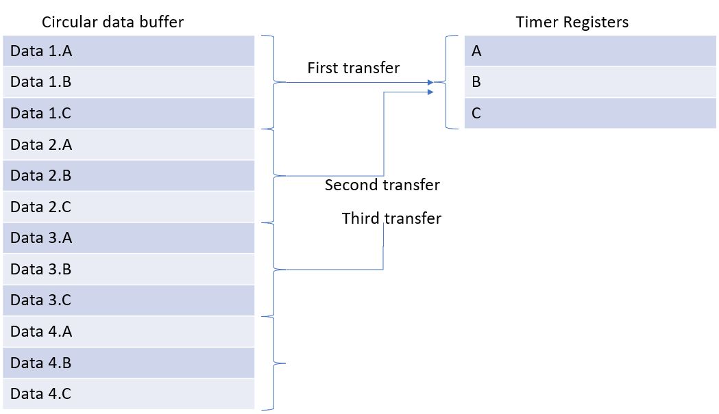

I am attempting to write to three timer registers from a circular buffer on a single event. How should I best configure the DMA to do this?

  • A block transfer doesn't really do what you want, since it does the full block then it is complete; you won't be able to "walk" through your source array.
    I'm guessing you want to write to CC_01[] and CC_23[0]. If you're not using CC_23[1], you could use a Single transfer with a long-long-word (4 words) transfer, where the 4th word is a dummy.
  • Hey Grant,
    I think what Bruce is saying is closer to what you want. Single transfer with a channel size of sizeof(circular_buff)/ sizeof(long long)

    Ok, so I think I have this working for single transfer from a block address to a fixed address. (and I was correct where the word alignment needs to be specified for this to work correctly).
    I can post this here or I can zip it up and send it to you.
    Munan
  • Hey just wanted to update on the forum for closure, we settled on single transfer for block address to fixed address using long long.
    I also wanted to mention in case anyone is curious, the timer trigger for 2 DMA channels requires each DMA channel to have its own subscriber port and we used the event channel 12 in order to have a 1-2 splitter for the timer event to trigger each DMA channel simultaneously. (it's not exactly simultaneous because the DMA does arbitration since only one physical transfer can happen at a time)
    Otherwise you can map both DMA channels to 1 timer event subscriber port, but what ends up happening is the first channel will complete its transfer before the second channel will start.
