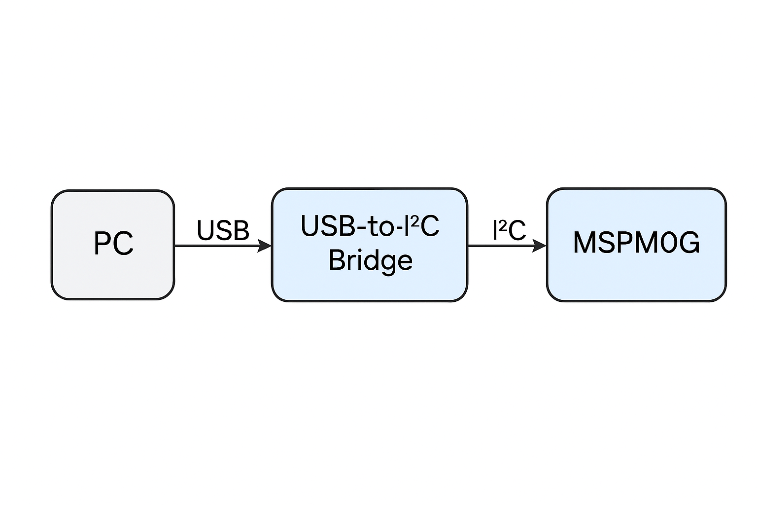

Is there a BSL host tool with I2C support? Are there any plans to provide such a tool?
Ideally, I'd like to send commands from a PC and have it perform USB-to-I2C conversion. The following is an example diagram.

We don't have the GUI supporting I2C now. And we currently don't have the plan to do it because there is not general USB-I2C bridge tool for our customer now. You can try to develop a GUI supporting I2C according to the USB-I2C tool you used, based on our UART GUI. You can find the UART GUI resource in SDK mspm0_sdk_2_07_00_05\tools\bsl
and you can download the UART GUI too from: [FAQ] MSPM0L1306: BSL_GUI_EXE update
