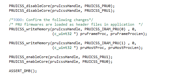

Follow up the issue from Top customer. Customer need to achieve the txclk and data signal at different sequency. So we provide a way via configuring the register. However the register will be clear after the PRU firmware loaded.
The ECAT PRU firmware is based on SDK version ind_comms_sdk_am243x_2025_00_00_08.
Writing the TXCFG0_TX_CLK_DELAY value before the following PRU firmware load function works, but this value is cleared to 0 after the PRU firmware loads.
It requires writing to register bits 28-31 again after a delay of approximately 2 seconds after the PRU firmware loads for the write to succeed.
Customer need to speed up the boot time and avoid this 2 seconds delay.
Any good ideas about this?

    The EtherCAT PRU firmware rewrites the full MII_RT_TXCFG0/1 registers — including bits 30:28 (TX_CLK_DELAY) — every time a port state change is detected. This happens repeatedly during firmware initialization as the port scanning loop runs, which is why any pre-load write gets overwritten and a post-load write only "sticks" once the firmware has settled.
    Recommended Solution (no firmware change):
    Set the TX_CLK_DELAY bits inside the TI_VS_PORT0_TX_START_DELAY shared RAM parameter before enabling the PRU cores. The SDK populates this parameter during EtherCAT stack initialization. Include the desired TX_CLK_DELAY value in bits 14:12 of both the FWD and REV TX_START_DELAY 16-bit words:
    bsp_init() writes the TX start delay to PRUSS Data RAM at ESC_ADDR_TI_PROCESS_PATH_TX_START_DELAY (offset 0xE10) before the PRU firmware is loaded. When the PRU firmware starts, it reads this word from DRAM and writes it to the MII_RT_TXCFG hardware register.
    Because the stored word only encoded TX_START_DELAY (bits 9–0) and left bits 14–12 as zero, the PRU firmware always write TX_CLK_DELAY=0, overwriting any value written directly to the hardware register before the PRU started.
    By encoding TX_CLK_DELAY in bits [14:12] of the value written to DRAM[0xE10-0xE11], the PRU firmware will automatically preserve the correct TX_CLK_DELAY setting every time it initializes the MII_RT_TXCFG register. No post-load write and no 2-second delay are needed.
