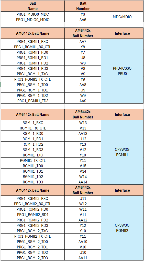

Could you verify whether following two RGMII port from CPSW3G and one RGMII port from PRU ICSSG can be interface to each gigabit Ethernet Transceiver over RGMII ?
So there are total three Gigabit Ethernet Transceiver, DP83867IRRGZR over RGMII interface
For PRU-ICSSG, it will be used for the deterministic ethernet.

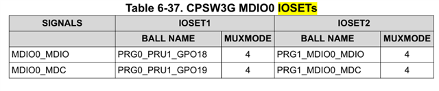

Could you also verify whether following MDC/MDIO interface can be interfaced to each PHY IC including PRU-ICCSG ? Each PHY has an uniquie PHY Address.
