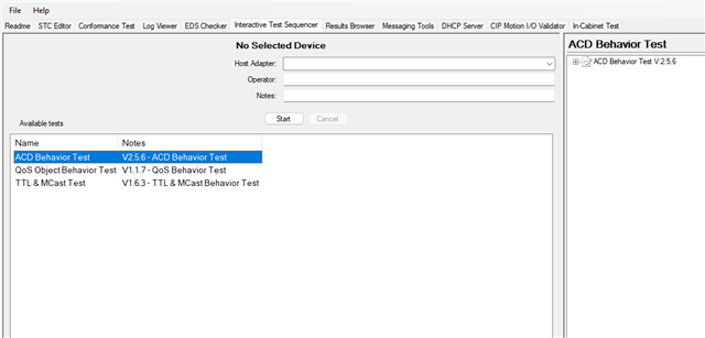

  • Hi Yashaswini,
    for ACD behavior test and QoS, you could use the conformance test "Interactive Test Sequencer" and follow the test instructions.
    For all the other tests, you would need special setup, the setup and the test procedure is described in "EtherNetIP Sample Test Report.xlsm" file, located in Conformance test tool installation path.
