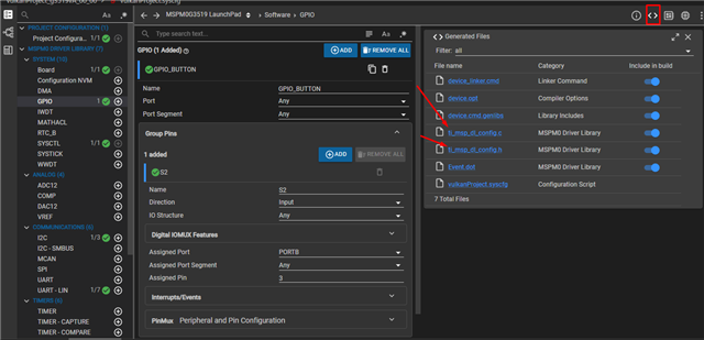

The functionally equvalent SYSCONFIG projects may generate different but functionally equvalent code.
In the attached examlple:
  1. Load test.sysfg inti standalone SYSCONFIG GUI and generate code test.zip
  2. Copy generated files somewhere
  3. Delete GPIO_PORTA_LO.PIN_0 and GPIO_PORTB_HI.PIN1
  4. Save SYSCONFIG configuration
  5. Re-add  GPIO_PORTA_LO.PIN_0 and GPIO_PORTB_HI.PIN1
  6. Generate code
  7. Generated files will be different
Possibly do steps 3-6 in a different folder.
