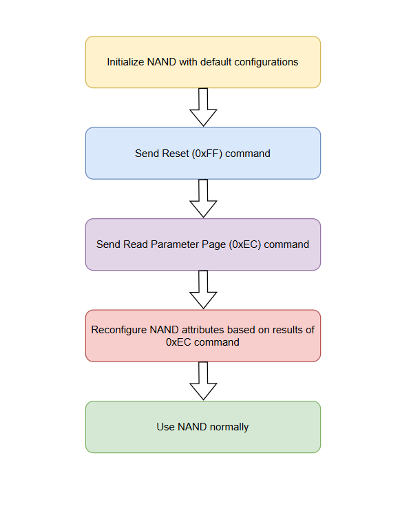

Our Proposed Design Flow:
  1. Initialize the NAND with conservative default configurations.
  2. Issue a RESET (FFh) command as the first operation because it is required by some vendor constraints.
  3. Issue the Read Parameter Page (ECh) command with a 00h address cycle.
  4. Parse a 256-byte paramaters copy and map its data to re-configure the NAND attributes at runtime based on these results.
  5. Write the registers with the true configurations.

  • Hello Reem Abo el Khair,

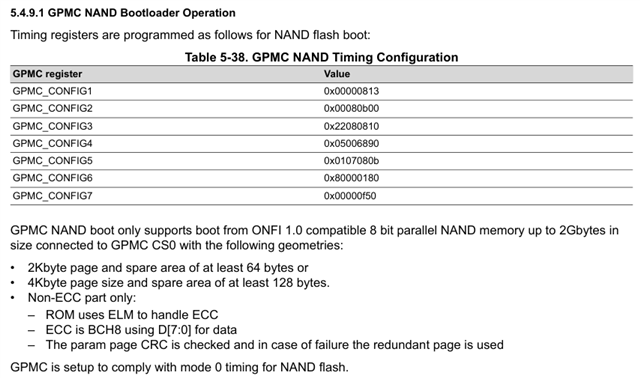

  • Hello Reem Abo el khair,
    I'm adding software support to check your code to interrogate parameter page.
    Regarding ROM, ROM on AM62x does not extract timings from the parameter page on NAND flash. It is rigid with the NAND that are supported and that is documented in TRM 5.4.9.1 GPMC NAND Bootloader Operation (copied below).
    The last line in TRM 5.4.9.1, “GPMC is setup to comply with mode 0 timing for NAND flash”, refers to the attached ONFI spec - Table 12 Timing Modes 0, 1, and 2. Refer to https://onfi.org/files/onfi_1_0_gold.pdf
    The registers provided in TRM Table 5-38 try to match these ONFI mode 0 timings.
    These slow timings are intended to support all ONFI 1.0 compliant NAND flash devices without interrogating their timings.
    The ROM also has restrictions on bus width (8-bit only), density (upto 2Bytes), page size (2K, 4K only), ECC (ECC internal to FLASH not allowed), ECC (BCH8 required).
    I have looked at the code, and it seems to be correct.
    You are sending the EC followed by 0x00, which is correct.
    After issuing the read command for 768 bytes, you are waiting 0.2 seconds before reading the data.
    My suggestion is to set the WaitReady pin to true instead of using a delay, and check whether the status is ready before reading the data.
    In your test case, what exactly happens after issuing the read command? Are all 768 bytes corrupted, or are the first 256 bytes correct?
    Can you please explain the issue you are facing?
    The MCU SDK's GPMC requires timing parameters that are tailored to specific NAND devices and operating conditions. These parameters are not universal because each NAND manufacturer has different electrical characteristics. Operating voltage also significantly affects timing. Higher voltage allows faster access, while lower voltage requires slower, more conservative timing.
    We have shared the timing parameters for your NAND device operating at 1.8V.
    If we implement generic NAND timing parameter support for almost all devices, you will experience performance degradation similar to what you already faced. At that time, we optimized the timing parameters specifically for your device.
    We follow an Excel sheet approach. You can provide all timing details from the datasheet, and based on this information, you can choose the appropriate timing parameters.
    /cfs-file/__key/communityserver-discussions-components-files/908/GPMC_2B00_tool.xlsm
    The current MCU SDK does not implement ONFI mode. The SDK does not send mode-switching commands to change NAND timing behavior. The GPMC timing parameters are configured once during GPMC initialization and remain fixed throughout operation.
    This approach is acceptable because the fixed timing parameters are configured to work with the NAND device mounted on the EVM.
    Every NAND read operation follows proper timing sequences (Even ONFI command ). Commands are sent according to the configured timing parameters. Data transfers respect access time and cycle time specifications with the existing timing values.
