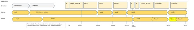

This is a continuation of the thread below.
:(1) MSPM0G1507: When communicating in Fast-mode (400kHz), the controller side shifts the data by 1 byte. - Arm-based microcontrollers forum - Arm-based microcontrollers - TI E2E support forums
I have confirmed the customer’s actual usage. The MSPM0G1507 will be used as the target device, and the controller may perform both normal START/STOP communication and repeated START communication.
In the actual use case, this is not an echo operation. As shown in the figure below, the data received from the controller is treated as address information, and the target returns the data stored in its address space starting from the address indicated by the last received data byte. Therefore, each time the target receives data, it needs to move the corresponding data into the TXFIFO in advance.
With that in mind, although this is a repeated question:
Q: When using repeated START, are there any concerns with moving data into the TXFIFO at the timing of the RxFIFO trigger (threshold = 1) as a method of preparing the TXFIFO before the repeated START trigger occurs? If there is any other recommended approach, please let me know.
For reference, I modified the program original thread provided as attached so that the data is moved into the TXFIFO at the timing of the RxFIFO trigger (threshold = 1). I would appreciate it if you could let me know whether there are any concerns with this method or whether there is another recommended approach.

  • Hi O.H,
    I'm not sure whether I understand correctly, you want to fill I2C TXFIFO when there is first RX byte received in I2C target, so the I2C data will be ready before the "R" sequence in repeat start situation, am I right?
    It sounds working, just notice to flush TXFIFO before the first time you fill the TXFIFO. Have you tested on this logic and meet any problem?
  • Hi Pengfei Xie,
    Thank you for your reply.
    That is mostly correct. More precisely, I am not particular about the exact timing of when the RX byte is received. Any timing is acceptable as long as the I2C data is prepared before the "R" sequence in the repeated START transaction.
    At this point, I have not seen any issues in the actual behavior.
    The reason I am asking is that I would like to confirm whether TI has any recommended method for this use case, and whether there are any potential concerns or issues that could be expected with this approach.
    O.H
  • Hi Pengfei Xie,
    Sorry for rush you. Is there any additional comment or information?
    O.H

  • Hi Pengfei Xie,
    then the TX data has better to be prepared when the first byte of repeat start command received from controller.
    If "the TX data is prepared when the first byte of the repeated START command is received", the data shift into the TX FIFO cannot complete in time, resulting in a 1-byte shift. This is exactly the issue we are facing, and that is why we are asking this question.
    As background, when using the sample project as a base at 400 kHz with both STOP+START and repeated START, we encountered the issue that the data shifts by 1 byte.
    For STOP+START(400 kHz), we understand from your answer in the other thread that the recommended solution from TI is to prepare the TX data at the STOP interrupt.
    For repeated START(400 kHz), does TI have any recommended usage or recommended implementation method? Or is there no specific recommended method?
    At present, may I consider the current method — moving the data into the TX FIFO at the RxFIFO trigger timing (threshold = 1) — to be the recommended approach?
    The hardware supports communication up to 1 MHz. If you have already performed communication tests at 400 kHz or higher, I would appreciate it if you could share any operating method or implementation approach that worked well in those cases.
    O.H

  • Hi Pengfei Xie,
    I understand that there is no particular recommended approach for this case, and that it needs to be evaluated and confirmed based on actual operation.
    If you have any information on this, could you please let me know whether your team has conducted communication tests using repeated START at 400 kHz or higher? The sample project appears to be based on 100 kHz.
    O.H
  • Do you intend to do this without clock-stretching (as mentioned in the other thread)? Clock-stretching is the primary (arguably the only) flow control mechanism in I2C. Without flow-control, there will always be a race. The magnitude of the race in the repeated-start case is (1+8+1) bit times, or 25usec with a 400kHz I2C -- 800 SYSCLKs at 32MHz, but that includes any Wakeup time.
    Your charts seem to describe a very restricted version of the "register" (or perhaps "EEPROM") model, where:
    1) No data is written, so every Write is 3 bytes (memory address).
    2) Every Write is followed by a Read of a known length.
    If so, your Rx code could count to 3 and start filling the TXFIFO immediately. Without (2), there's a chance this will leave stale data in the TXFIFO; there is a mechanism in the I2C unit for dealing with this but it requires clock-stretching to work. Without (1), the Target won't know whether there is a Read coming until the R/W bit in the subsequent Start, so the magnitude of the race is approximately 0.
    Alternatively, you could require a Stop (no repeated-Start) and an artificial delay in the Controller between the Stop(W) and Start (R). There is some precedent for this (rather rare though), and it just improves the race rather than eliminating it.
