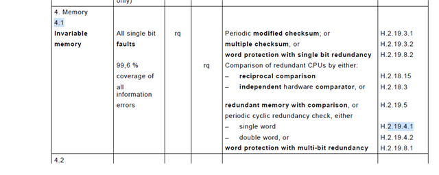

  • Hi Fleenor, thanks for all the information. Our concern is the special condition where a fail of a 63 bit 1/0 scenario can not be detected.
    Looking into safety lib documents I could not identify a justification or explanation how that is covered as such a condition is not excluded by the class B requirements.
    Do you have some input on this?

    thank you for your input but from my perspektive that is an AI generated answer. If so its not trained well enough for that. So please jump in yourself.
    The topic from the AN provided in the other ticket and I was referring by the 63 bit 1/0 scenario is the following one.
    In that case not 63 bits are flipping only one bit flip can not be detected. And from what I understand that relates to the specific implementation where TI includes addresses into the ECC calculation (sry, dangerous half knowledge feel free to correct me, but havent found information about that from other chip vendors).
    So from my perspective the statement about reasonably foreseeable faults is still valid and that case has to be covered. which leads me to your next point about the layered diagnostic library. what i see only the first point can be valid as the other methods are usually used for ram not for flash which is our concern at the moment. So still i would ask for a reference which mentions for example that the crc or any other method is installed to cover such specific scenario.
    BR

  • Hey Norbert,
    For a valid programmed flash word (64-bit in this case), on every read, the ECC is checked, regardless if the programmed data is all 1s or all 0s.
    When is the check skipped (and why)?
    The check is only skipped when the data written into flash word is all 1s or all 0s AND its ECC is also all 1s or all 0s (which will be the case in an unprogrammed flash). In this case, to avoid reporting a multi-bit error, the check is skipped when {ECC, data} is all 1s or all 0s.
    This special handling is typically done in the flash wrapper to take care of an unintended reads to an erased flash line triggering spurious uncorrectable error or NMI.
    Does this mean the ECC is not safety complaint?
    We ensure device level compliance to IEC61508, enabling SIL-2 and SIL-3 systems, Similar to the MSPM0Gx, we can still ensure compliance with IEC60730 Class B, by covering the boundary misses via software, this is also what we have been using on some of our C2000 family of devices.
    Shaunak
  • Hi  , thank you for the input.
    When I look into the now accessable safety/diagnostic lib for the mspm0 i do not find any hint that ecc contributes to the safety concept. Did I miss anything? This is just important from our side as we assumed always that such provided lib are more effective and utilizing the all the available hw units (like ecc) to safe computation time but for flash and ram this is purely implemented in sw right?

    you mentioned that "IEC60730 wants separate mechanisms that don't depend on the subsystems being tested." can you point me to the specific section where i can find that information?
    you also wrote "So even if you wanted to rely on ECC status flags, you'd have coverage gaps. The software CRC catches everything regardless." which I'm not fully sure about as i found the following section in the iec60730 where for flash i would say the following applies and it requests a coverage of 99.6%.
     how do you understand that tabel?

  • Hi Norbert,
    I connected with our MSPM0 team as well, and discussed the on-going topics in this thread. I will summarize the discussion below:
    I was referring to Clause H.2.16 and Table H.1 in Annex H of the IEC 60730-1 standard, which dictates that diagnostic and test methods must be mutually independent of the subsystems they are verifying. Incase I propagated the point in some other way creating a confusion, hope this clears it up.
    Apologies for the confusion, by everything regardless, i mean to point that the hardware limitation can be overcome by the software implementation.
     The AM13E230x/ MSPM0 hardware ECC check is skipped for unprogrammed flash and all-0s/all-1s boundary cases to prevent constant false error flags. To ensure IEC 60730 compliance, developers rely on the MSPM0 Diagnostic Library to execute software-based flash tests, which guarantee the necessary safety coverage. The MSPM0 Diagnostic Library provides certified, pre-written software APIs like Flash Periodic Self-Test routines. These software routines are typically implemented in the application's background or startup routines to programmatically scan and verify the entire Flash memory range. The software diagnostic tests (often using robust CRC or checksum algorithms over the Flash contents) functionally cover the boundary conditions ignored by the hardware, ensuring full test coverage is systematically achieved.
    which leads me also to the next question. in SPNA139 it is mentioned that ".Likewise, about 0.4% of all addresses give an ECC value of 0xFF  with a data pattern of 62 ones and two zeros." which fits magically that coverage, is that by intension to match the safety standard?
    IEC 60730 Annex H requires diagnostic coverage of ≥ 99% or ≥ 99.6% (depending on the specific Class B MCU architectural assumptions) for memory components. The skipped-check boundary condition is mathematically constrained. Because hardware ECC checks are only skipped when both the data and the ECC values evaluate exactly to all 0s or all 1s, the statistical probability of the affected addresses naturally falls well under the 0.4% allowance. Precise calculation of skipped checks relies on the properties of the device’s Hamming-style ECC. Since the exact ECC polynomial and bit-length are proprietary to the MSPM0 architecture, developers do not need to calculate every single affected address manually. Instead, the safety manual for the Diagnostic Library provides pre-calculated, deterministic bounds and proofs for coverage limits, allowing you to cite TI’s certified safety documentation directly in your certification audits. We are not pre-calculating the affected addresses/or know in advance about the addresses being affected
    So the numbers are not forced to fit magically to ensure the coverage, rather the statistical probability ensures that we are on the safer side. Also, to make sure there are no more confusions, the RAM ECCA checks are parity based, no ECC checker like flash, so the boundary case only applies to the Flash and not the RAM.
