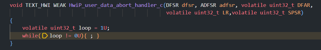

When I start debugging the five projects by launching the debugger through the system project (ipc_rpmsg_echo_callback), put all four cores into "running" state (F5 on each core), and check the Serial Console for the debug message, only part of the first message is displayed:
At that point, cores 0-0 and 1-0 are executing the following abort handler:
Cores 0-1 and 1-1 are inside this function:

    - As already mentioned in my original post, I imported TI's official ipc_rpmsg_echo_callback example. This example uses FreeRTOS on all four cores. Debugging the bare, imported project (no changes to it) leads to two of the cores eventually reaching HwiP_user_data_abort_handler_c() -> The project is broken out of the box.
    - ipc_rpmsg_echo, that uses FreeRTOS only on the main/controlling core, works out of the box.
    - When I copy the program code of the ipc_rpmsg_echo project verbatim into the import of ipc_rpmsg_echo_callback, three cores eventually reach HwiP_user_data_abort_handler_c() -> Project still broken, despite program code that I know works in another project that is set up without FreeRTOS on three cores.
    - I have also tried to make RPMsg work on an empty project using four FreeRTOS cores. This breaks the project, as well. Again, some of the cores eventually reach HwiP_user_data_abort_handler_c() and no RPMsg communication succeeds.

  • Hi Deigo,
    Can you take a look at the below E2E and check if it helps, to me it seems like a very similar issue. The linked E2E also has a few links to other E2Es for reference
     LP-AM263: LP-AM263: Definitive Method to Debugging
    Shaunak
  • Commenting out OnTargetConnect() inside AM263Px.gel did the trick. Thanks!
