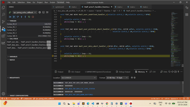

My team has been trying to debug project on LP-AM263 but we have not been able to do so. We have tried two sample projects for the same. This are provided by TI & we have not changed a single code line. Projects are rpmsg_echo_callback & empty.
We have tried two methods to debug projects

In both the methods, debugging doesn't work. We have an error on R5_0 core attached as per attached Screenshot. Code loops under HwiP_user_data_abort_handler_c.

  • In both the methods, debugging doesn't work. We have an error on R5_0 core attached as per attached Screenshot. Code loops under HwiP_user_data_abort_handler_c.
    Could you please confirm if you’ve set the boot mode on your board to DevBoot mode when doing this?
  • Yes, debugging is done in DevBoot Mode.
  • The switches are inverted in Launchpad settings, for example 1011 would need to be set as 0100.
    Is the following switch setting done.
    Can you also read the value in the register MSS_TOPRCM_SOP_MODE_VALUE (5320 0024h) to confirm the boot mode is correct. Data abort is usually seen when you try running the code from CCS in QSPI bootmode.

    Value of MSS_TOPRCM_SOP_MODE_VALUE is 0x0000000B.
     Gel Output confirms the same.

  • Do you see this issue with multiple boards? Also, do you see this while running just a single core project as well?
  • No, single core projects work as expected. We only have one set of LP-AM263 hardware so we cannot test it on additional boards.

    Also, one recommendation from my side would be, use either:
    - QSPI Boot-mode with SBL NULL flashed and then load the .out files
    - DEV Boot-mode with no SBL flashed and gel scripts doing the initialization.
