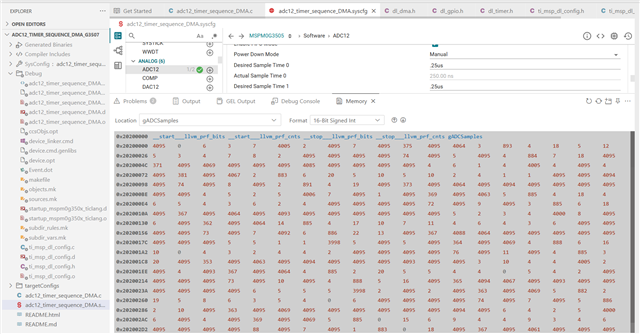

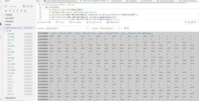

  • Here i have discussed about the ADC capture speed through DMA(512 samples). Our discussion is the 500Khz pulse input signal capture through ADC channel 1 with the sampling rate of 0.1uS.
    As per the sampling rate ON state should have 10 sample and OFF state should be 10 sample. But we are getting 1 or 2 sample that also not proper sequence, so is it to confirm the 500Khz input signal with sampling time of 0.1uS for 10 sample count possible with this MSPM0.
    Please find the adc12_max_freq_dma capture log ADC 512 sample data.

  • Please find the "adc12_timer_sequence_DMA" sys cfg modified file for your review.

  • Hello Baskar,
    I have checked the datasheet of M0G1107, that the max ADC sampling frequency in 12-bit is just 4Msps, which is 0.25us, so the 90ns sampling window you set is too small, by the way, what is the reference of ADC, it is VDDA, or VREF?
    BR,
    Janz Bai
  • Default VDDA 3.3V as ADC reference voltage. As per your suggestion configured the ADC sampling time to 0.25us, but even it is capturing sampling data is not proper as below for your reference.
    As mentioned VDDA 3.3V as ADC reference and please clarify the ADC sample collection latency time is based on ADC number of channels. Here MSPM0 has 12 channels so one ADC sample collection will take 12 FIFO time, is it correct?
