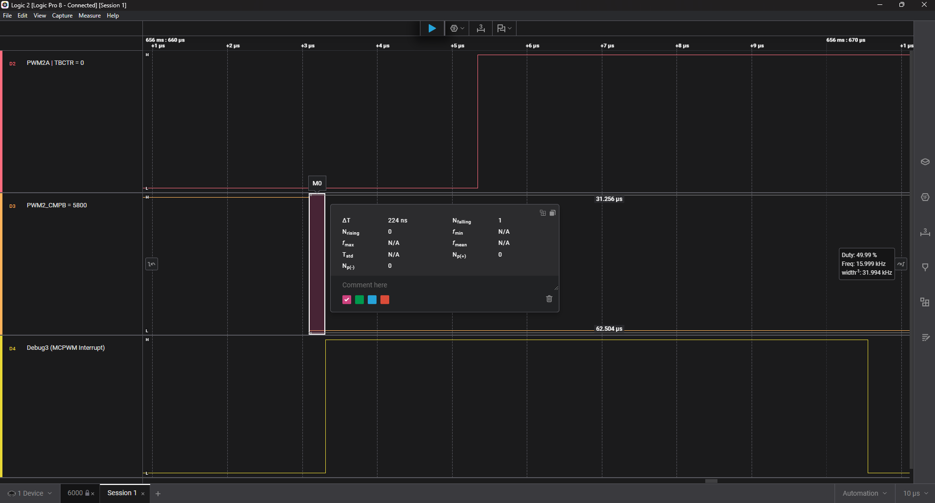

I am observing interrupt latency of around 240ns (MCLK = 200MHz) . Below are the syconfig configuraitons
Configurations
  • MCPWM4 Period is kept 16KHz (6249 Ticks), up count, No prescaler. MCPWM4 generate SyncOut pulse for eCAP when timebase counter equals to zero.
  • PWM2_CMPB = 5800 - this is used to generate accurate Pulse to verify the MCPWM interrupt latency
  • CMPC = 5800 - This is used to generate the MCPWM Interrupt(5800 is some random number. The goal is to generate the interrupt just before the time base counter becoming to zero)
  • PWM2A is configured to toggle When TBCTR = 0
  • PWM2B is configured to toggle when TBCTR = PWM1_CMPB On Up Count
  • ET1 : when the Time base counter is equal to CMPC, which is the same as PWM2_CMPB (5800). ET1 is configured as the source to generate interrupt
  • The priority of the MCPWM interrupt is kept the highest. Debug3 pin is toggled in ISR as first statement.

  • There is interrupt latency observed (around 230ns) for MCPWM ISR. Please suggest if it can be improved or this is expected. image.png
    NOTE: Logic Analyser is configured to sample at 250 MHz

    Thank you for the detailed post. The ~224-240 ns latency you are observing is higher than the theoretical minimum for the AM13E230x (Cortex-M33) and is most likely attributable to Flash execution overhead. Below is a breakdown of what is contributing to the latency and what can be done to reduce it.

    At 200 MHz, 240 ns equates to approximately 48 CPU cycles. The Cortex-M33 hardware minimum is ~12 cycles for context save alone, so the remaining overhead is most likely coming from Flash wait states if the ISR is executing from Flash.
    Primary Recommendation: Execute ISR from SRAM
    On the AM13E230x, Flash access at 200 MHz incurs wait states that directly add to observed latency once the CPU begins fetching ISR instructions. Placing the ISR in SRAM eliminates this overhead.

    Your logic analyzer is sampling at 250 MHz, giving a resolution of 4 ns per sample. The reported latency carries an inherent uncertainty of approximately +/-4 ns, so the true value sits within a ~8 ns window around your measurement. This does not affect the diagnosis but is worth keeping in mind when validating the improvement after the SRAM change.
    Please give the SRAM placement a try and let us know what latency you observe afterward. If the latency remains higher than expected after that change, we can look further into NVIC priority configuration and any potential bus contention on the SRAM interface.
    Zackary Fleenor
  • Hi Zackary Fleenor
    Thanks for the detailed response. After making the Suggested changes I am able to achieve latency up to 125 ns. Here are the changes made.
    1. Increasing optimisation to -O2 (MCPWM4 Interrupt does not happen on -O3 somehow)
    2. Shifting ISR into RAM
    3. Shifting functions into RAM
