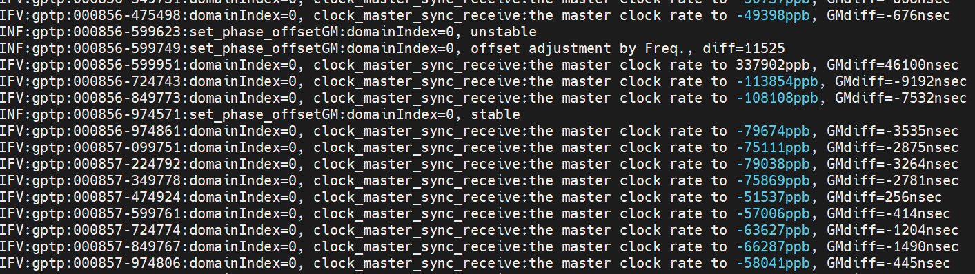

    We are currently testing on the SDK11.0 version using the gptp_lwip_cpsw_am64x-evm_r5fss0-0_freertos_ti-arm-clang example. Due to requirement changes, we need to use two real-time R5F cores, so we migrated the example from R5F0-0 to R5F1-0. After modifying the related configurations, ethernet works fine. However, during testing we encountered some issues and would like to consult you.

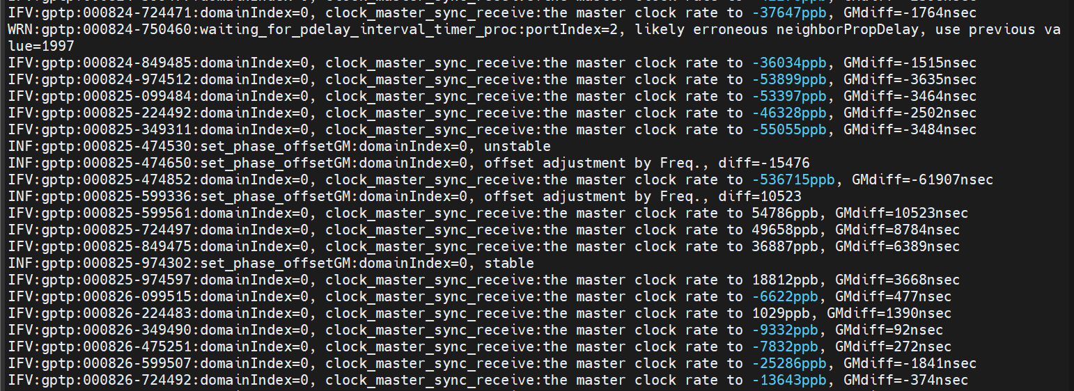

    When using R5F0-0 with three cascaded terminals (e.g., A connected to B, B connected to C), where A is the master clock and B/C are slaves, the printed time difference values for B and C are within the expected range, as shown in the figure below. But when using R5F1-0, B remains relatively stable and its gmsync value is basically 2, while C always stays at 1, and the computed time difference jumps significantly, accompanied by some warning messages.

        We have resolved the previous issue regarding multiple cascades. However, the current problem is that when multiple stages are cascaded, only the first stage can perform time synchronization normally; the other stages remain stuck in the synchronization process, and the synchronization flag never changes to 2. We also found that this phenomenon occurred because originally the system was running on the R5F0-0 core, and then we switched it to the R5F1-0 core. When we switched back to the R5F0-0 core, the problem disappeared. I am wondering if there is anything we should pay attention to when using these two cores.
  •     I can send you the configuration we are using. Could you help analyze whether there is any issue with our configuration? The rest of the code is completely ported from the R5F0-0 core without any modifications.

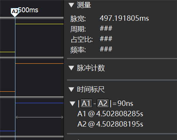

        In my previous post, I mentioned generating integer-second pulses. Using the patch you provided, I was able to generate integer-second pulses with Genf. However, during testing, some issues have arisen. We are using four devices: A -> B -> C -> D, where A is the master clock, and they are cascaded sequentially. In the early stage of operation, the integer-second pulse edges of B, C, and D were all within 1 µs, as verified using a logic analyzer. But after running for more than 12 hours, we observed a 20 µs difference between B and C, and also a 20 µs difference between D and C, while the difference between D and B remained within 1 µs. This phenomenon is quite strange. If it were a cumulative error, the difference between D and B should also be large. Could you please help analyze the possible cause?

        I discovered an issue with the Genf output. Earlier I reported that after time synchronization is stable, configuring the Genf pulse output should allow different terminals to output at the same moment. The initial test showed the same behavior, but after running for more than 12 hours, deviations appear in the pulse intervals between different terminals — which is what I described above. This happens when the Genf output is configured only once after synchronization is stable.
        I ran another test: first, after synchronization is stable, the Genf PPS (pulse-per-second) is output, and then the Genf output is reconfigured every 10 minutes. After running for over 12 hours, I found that the pulse intervals between different terminals were basically stable and stayed within 2–3 µs. This phenomenon basically confirms that Genf does not adjust its output based on the synchronization timing. Is my understanding correct? If so, I hope you can provide a corresponding solution. Thank you very much.
