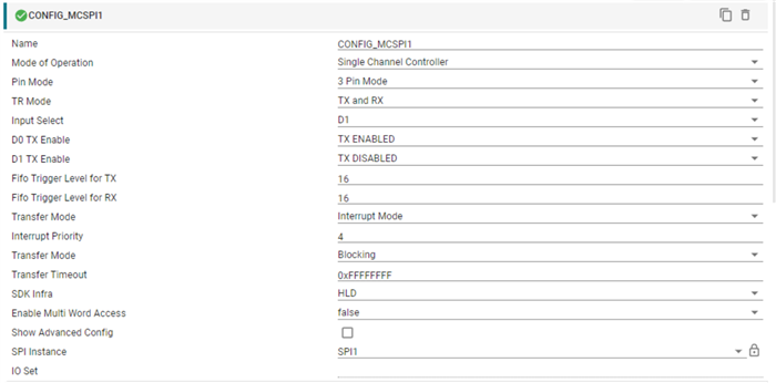

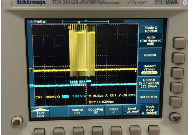

Hi Team,
I am currently working on interfacing the DAC81408 module with the AM2634 controller board using the SPI1 interface, but I am unable to observe any output from the DAC.
The connections made are as follows:
  • SPI1_D0 → J8 (Pin 3)
  • SPI1_D1 → J8 (Pin 4)
  • SPI1_CLK → J8 (Pin 8)
  • SPI1_CS → J8 (Pin 2)
Additional details:
  • Common ground is established between the DAC module and the controller board.
  • Proper supply voltages (VCC and VSS) have been applied.
  • The reference voltage has been verified, and I am measuring 2.5V at J1 (Pin 7).
Despite these checks, I am still not able to get any output from the DAC. I have attached my code for your reference.
This issue is currently blocking my project progress, so I would greatly appreciate your help at the earliest. Could you please advise if there are any specific SysConfig settings, SPI configurations, or initialization steps required for proper communication?

void SPI_Transaction(MCSPI_Handle spiHandle, uint8_t *txbuffer, size_t txSize, uint8_t *rxbuffer, size_t rxSize)
    MCSPI_OpenParams openParams;
    MCSPI_Transaction spiTransaction;
    int32_t transferOK;
    MCSPI_OpenParams_init(&openParams);
    //spiHandle = MCSPI_open(CONFIG_MCSPI0, &openParams);
    spiHandle = MCSPI_open(CONFIG_MCSPI1, &openParams);
    //spiHandle = MCSPI_open(CONFIG_MCSPI2, &openParams);
    if (spiHandle == NULL)
        DebugP_log("Error: Unable to open SPI handle.\r\n");
        return;
    SPI_CS_High_Low(0);
    MCSPI_Transaction_init(&spiTransaction);
    spiTransaction.csDisable = FALSE;
    spiTransaction.count = txSize+rxSize;
    spiTransaction.txBuf = txbuffer;
    spiTransaction.rxBuf = rxbuffer;
    transferOK = MCSPI_transfer(spiHandle, &spiTransaction);
    if (transferOK != SystemP_SUCCESS)
        DebugP_log("Error: SPI transfer failed.\r\n");
    SPI_CS_High_Low(1);
    MCSPI_close(spiHandle);

    Fix #2 - SPI Mode:
    - SysConfig configured to Mode 1 (CPOL=0, CPHA=1)
    - Verified multiple times that this setting is active

    Fix #4 - Conflicting Chip Select Control:
    - Code: spiTransaction.csDisable = TRUE
    - SysConfig: Pin Mode = 3 Pin Mode
    - CS is controlled exclusively via GPIO161

    OBSERVATIONS
     SPI signals (measured with picoscope):
       - SCLK: Clock pulses present
       - CS: Goes low during transaction
       - MOSI: Data being sent

    1. Loopback test result: Connect MOSI to MISO with a jumper wire and run spi_loopback_test(). Does it pass?
    2. Oscilloscope capture: Capture CS, SCLK, MOSI, and MISO during a Device ID read. The expected waveform should show:
      • Transaction 1: CS low, 24 clock pulses, MOSI shows 0x81 0x00 0x00, MISO high-Z
      • 10us delay
      • Transaction 2: CS low, 24 clock pulses, MOSI shows 0x00 0x00 0x00, MISO shows device ID

  • Hi Fleenor,
    I am following up on the DAC81408 interfacing issue with the AM2634_CC EVM board. I have implemented all the fixes suggested , but I am still unable to read the Device ID, which returns 0x0000.
    Fixes Implemented:
    1.A single global SPI handle is now used, opened once in init_spi and reused for all transactions, eliminating repeated open and close operations.
    2.SPI Mode 1, with CPOL equal to 0 and CPHA equal to 1, has been configured in SysConfig.
    3.The corrected two-transaction SPI read protocol has been implemented. The read command is sent in the first transaction, and the data is retrieved in a second transaction with a 10 microsecond delay between them.
    4.Manual chip select control via GPIO is being used with the csDisable parameter set to TRUE.
    5.A proper reset sequence has been implemented with a 10 millisecond assertion time followed by a 10 millisecond stabilization delay.
    Write transactions have been changed to write-only operations, removing the unnecessary dummy read buffer.
    The return value of MCSPI_transfer is now logged for debugging purposes.
    Test Results:
    1. SPI Loopback Test passed. A jumper wire was connected between MOSI on HSEC pin 75 and MISO on HSEC pin 77. Data was sent and received correctly. This confirms that the AM2634 SPI pins and the driver are working properly.
    2. Oscilloscope measurements confirm that the SCLK, CS, and MOSI signals are present and match the expected waveforms during the SPI transactions.
    3. Power supply verification results are as follows. VDD at pin 5 of J7 measures 5.0V. IOVDD at pin 4 of J7 measures 3.3V. VSS at pin 7 of J7 measures 20V. The VDD supply at pin 6 of J7 measures -20V. The reference voltage, VREF, at pin 7 of J1 measures 2.5V.
    4. For the control pins, the RESET signal on HSEC pin 162 measures 3.3V after initialization, which is the correct HIGH state. The CLR signal on HSEC pin 161 also measures 3.3V, which is the correct HIGH state.
    5. The console log shows that the SPI handle initializes successfully. The power-on verification and the CLR function test both execute. During the Device ID read attempt, MCSPI_transfer returns SystemP_SUCCESS for both transactions, but the final result is still 0x0000, causing the read to fail.
    Observations and Question:
    The MCSPI_transfer function returns SystemP_SUCCESS for both read transactions, so there are no driver-level errors. The successful loopback test proves the AM2634 SPI interface is functional. All power rails and control pins have been verified to be at the correct voltage levels. Despite all these checks, the Device ID consistently reads as 0x0000.
    With the loopback test passing and all voltages verified, what should be the next debugging step. The DAC appears to be powered, and its control pins are at the correct levels, but it is not responding to any SPI commands. Could there be a specific timing requirement or initialization sequence that I might be missing. This is urgent for our project timeline.
    I have attached the updated code, the SysConfig settings, a screenshot of the console output, and oscilloscope captures of the waveforms for your review.

    Sysconfig :
    Snapshots of output:
    1.Clock and Data line                                                             2. Clock and CS

    Issue 2: PICO Signal Amplitude Is Too Low
    Your oscilloscope capture of the clock and data lines shows Ch1 set to 100mV per division, and the data line amplitude appears to be in the range of 100 to 200mV. The DAC81408 requires a logic high of at least 0.7 times IOVDD on the SDI pin. With IOVDD at 3.3V, the minimum valid logic high is 2.31V. A 100 to 200mV signal will not be recognized as a valid input by the DAC under any circumstances.
    Please verify the following in SysConfig. Confirm that the SPI pin assigned as D1 (PICO) is correctly muxed as an SPI function output and not left in GPIO or default mode. Confirm the slew rate and drive strength settings for that pin are appropriate for SPI output. Also verify in the AM2634_CC EVM schematic that SPI0 ball pins A11, C10, and B11 actually route to HSEC pins 91, 75, and 77 respectively. If the ball-to-HSEC mapping is incorrect, your signals may be appearing on the wrong physical pins entirely.
    Issue 3: SPI Instance Mismatch Between Iterations
    Your most recent code opens CONFIG_MCSPI0, but your hardware is connected to the HSEC pins associated with SPI1 in your original configuration. Confirm that the SysConfig instance you have configured (showing SPI0_CLK/A11, SPI0_D0/C10, SPI0_D1/B11) physically routes to the HSEC pins where your DAC is connected. If there is any mismatch here, the correct signals will never reach the DAC regardless of software correctness.
