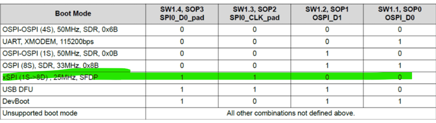

The bootmode is selected as QSPI mode on the SOP pins

  • Hi ,
    As per the image your have shared the BOOT mode you have set is XSPI bootmode. Here ROM tries to read the SFDP table of flash in 1s bootmode and tries to switch to 8D bootmode upon success. If fails it defaults to 1s boot mode and try to boot in 1S. In you case since flash is QSPI 8D switch will fail. And ROM default to boot in 1S mode.

  • Hi Mallikarjuanreddy,
    Since you are using a QSPI flash. Please change the boot mode to 0000 - 4S QSPI boot mode.

  • Hi
    1. I have changed the boot mode to 0000 , now nothing is booting.

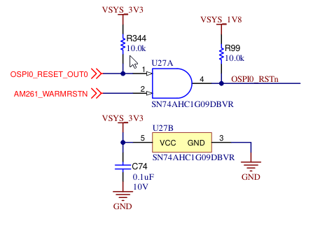

  • PORz Signal flow.pdf
    Please find the snip of the schematic to see the Reset flow and pin mux connection

    Thank you for sharing the schematic snippets!
    1. Can  you please tell me which PIN/Ball from MCU side is connected to QSPI0_RESET_OUTn?

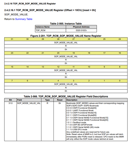

    5. Confirm the BOOTMODE from connecting to R5F0 and check the value of register - TOP_RCM_SOP_MODE_VALUE

  • HI
    GPIO20/D8 - QSPI0_RESET_OUTn
    Thank you for sharing the logs.
    and in 1S mode log shows as
    Failed to enable OSPI Reset Signal
    Failed to enable the ospi reset line!
    RBL does not have an issue. Boot has reached SBL stage.
    Log states that SBL failed because it was not able to issue reset to flash. This could be because of the difference in the reset architecture to the flash in the Launchpad (depending on the version of SDK used). Latest SDK + LP has direct reset to flash using OSPI0_RESET_OUT signal from controller ANDed with WARMRESETn pin.
    The package we are using is ZEJ package where OSPI0_RESET_OUT0 comes through GPIO20/D8 pin.
    In AM261x LP - package present is ZFG package . Here the OSPI0_RESET_OUT0 is brought out through GPIO61/K4 in LP-AM261x schematics.
    Ensure to migrate the sysconfig to ZEJ package and configure the QSPI pins as per the connections in your custom board.
    In our case, The QSPI flash does not have a dedicated reset line rather it is multiplexed with IO3 line. And since the size of flash is only 8MB - which is addressable by 3 byte address mode itself , it is technically fine to not issue a dedicated reset to flash. (provided we are not switching to 4 byte address mode).
    We can remove this OSPI_Reset to flash in hardware but before that just disable this pin in SysConfig and remove all Software calls for flash reset in code base.
    Removal of R220 is recommended so that High State of this pin (due to pull up R204) does not affect the OSPI IO3 data transactions in 4s mode in highspeed mode of flash operations. For now just disable in SW and test.
