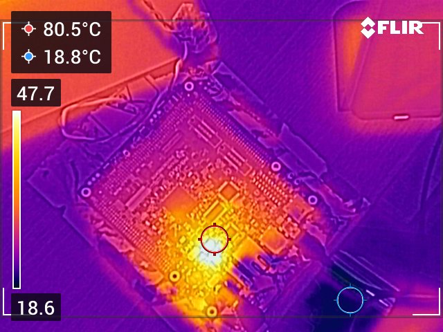

One of our customers purchased TMDSRM48HDK and claim the following,
Unfortunately, the following issue arose. The on-board USB debugger is accessible but cannot connect to the RM48. A component labeled "U39" on the board is getting very hot. The LEDs around the RM48 are all off. We suspect that the U39 chip is a voltage regulator for the RM48's power supply and that this supply is no longer functioning. Hercules_Problem_3.jpg
Could you please advise regarding this issue?
Thank you.
Usman

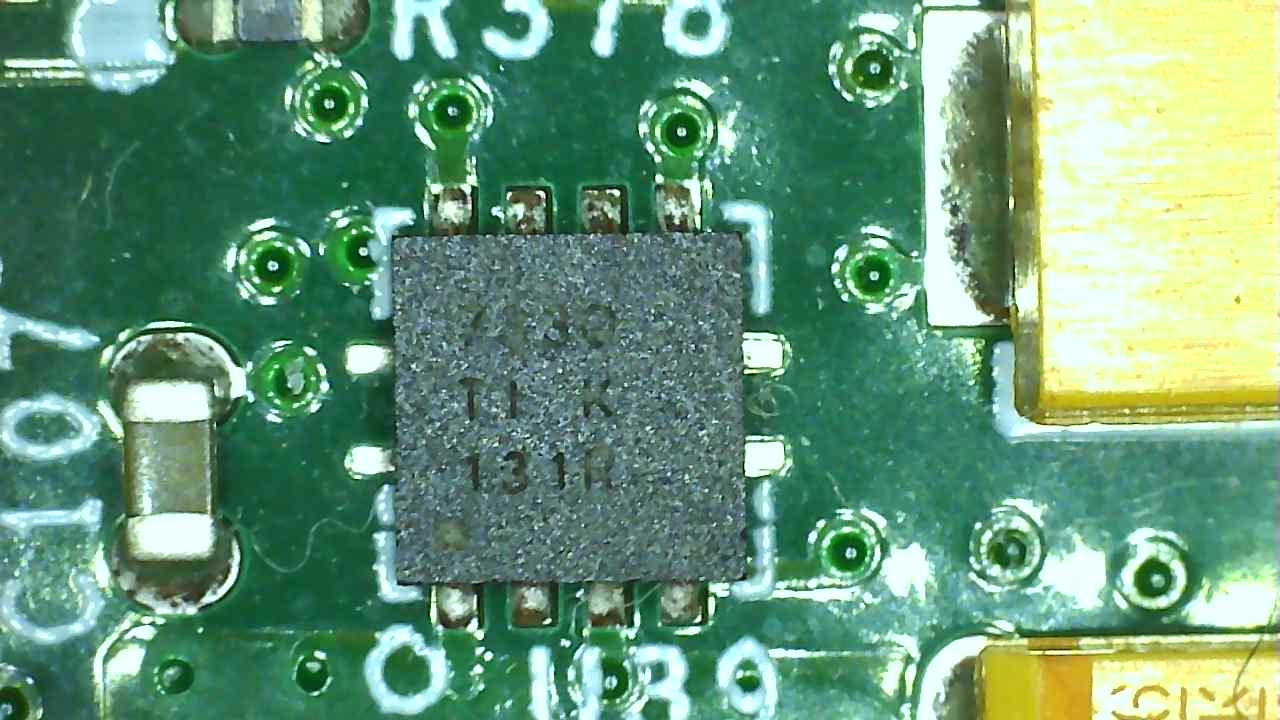

    Your customer's diagnosis is correct. U39 is the TPS73733QDRBRQ1, a 3.3V LDO voltage regulator that supplies power to the RM48 MCU [1][2]. The symptoms described — U39 running very hot, LEDs off around the RM48, and inability to connect via the debugger — all point to a failed or overloaded 3.3V power rail.
    What's Happening
    This is a known failure pattern on TI Hercules HDK boards. An identical issue was documented on the TMDS570LS31HDK, where U39 (same part, TPS73733QDRBRQ1) failed, causing the 3.3V LED to turn off and voltage measurements to read far below spec (e.g., 1.08V instead of 3.3V) [2]. Without a functioning 3.3V rail, the RM48 cannot power up, which explains why the debugger can see the USB interface but cannot reach the MCU.

    3. Replace U39 (TPS73733QDRBRQ1) if the 3.3V rail has no short. The part is available from DigiKey and other distributors [2]
    4. Alternatively, supply external 3.3V to the board's test points to bypass U39 and verify whether the rest of the board functions [2]
