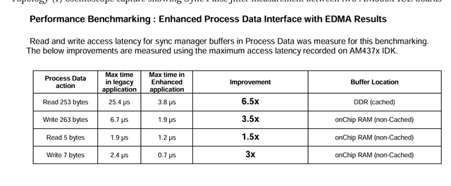

    There some possibilities like adding PRU DMA to R5F TCM but this requires firmware modifications as well as potential stack interface changes (we have done similar thing on AM437x EtherCAT implementation via EDMA) but this is not a planned feature as of now on AM64/AM243/AM26x
    https://dr-download.ti.com/software-development/driver-or-library/MD-JLNx46uE7Y/01.00.10.00/EtherCAT_Slave_Datasheet.pdf

  • Hi Pratheesh,
    Since EDMA is not supported on AM24 so far, please help have a look if there is any further optimizations could be done on the assembly code (for function bsp_myread.c) customer provided above, thanks.
    In the meanwhile, customer will analyze if the current configuration setup could meet their application level target or not. If it's not and no other optimizations could try then we may discuss the EDMA porting on AM24 in the future support later.
