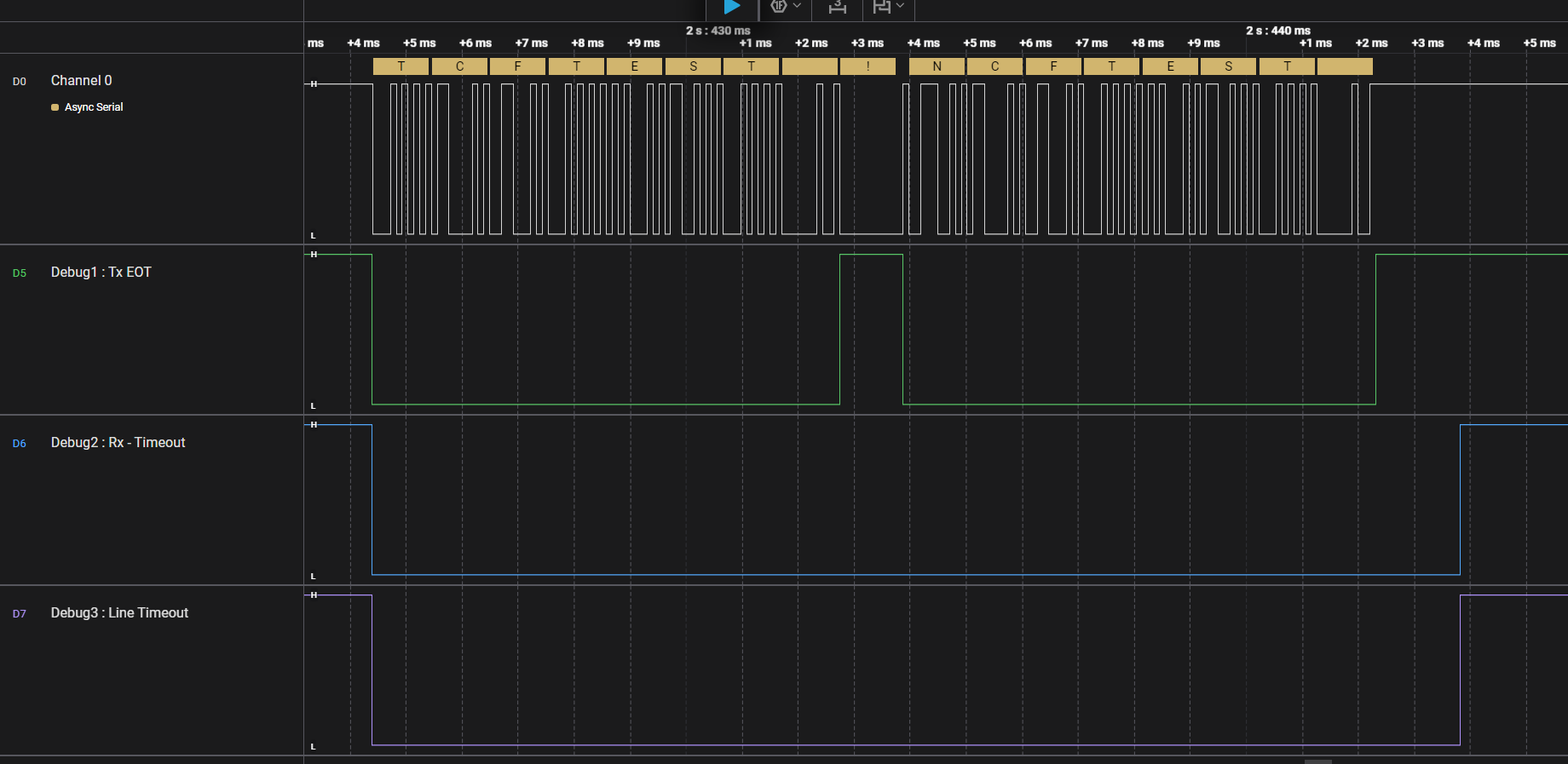

Note : TX and RX pins are exernally looped back and Logic analyser channel0 is connected to it. The optimisation levels are -O2

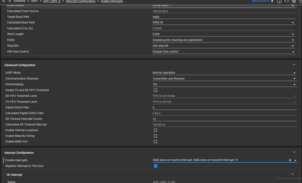

  1. what does it mean by Calculated RX Timeout Interrupt = 150 ns(in sysconfig) . Shall it depend on the baudrate ? How to decide this ?

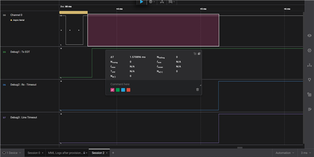

  2. I am seeing around 1.5 ms of delay for Tx Timeout and Line Timout
  • Here is the screenshot showing 1.5 ms delay between End of Data Transmission and Timeout ISR execution) . Typographical error above (1.5 ms of delay for Rx Timeout and Line Timout)
    surprisingly when I configure the baud rate as 115200 then this delay reaches upto 15-20 ms

  • I was using pre release user guide and the information was not clear. Thanks for the Input.
    Other than this I do see a bug in SysConfig. The Sysconfig seems to calculate the RX Timeout considering the Semi-MCLK instead of baud rate.
    Please check and confirm.
  • Hi Dheeraj,
    Yes, you're right. The SysConfig calculates the RX Timeout using the UART clock (Semi-MCLK), NOT the baud rate.
    Actual Calculation in SysConfig, From uart_common.syscfg.js (lines 972-981):
    function getRXTimeoutCalc(inst) {
        let sourceClkFreq;
        let timeout;
        sourceClkFreq = getUARTClockSourceFreq(inst); // Gets UART clock frequency
        timeout = (inst.rxTimeoutValue) / sourceClkFreq; // Simple division
        return timeout;
    Where getUARTClockSourceFreq() (lines 745-752) returns:
    function getUARTClockSourceFreq(inst) {
        let uartClockFreq = common.getBUSCLKFreq("UART"); // Get BUSCLK
        uartClockFreq = uartClockFreq / inst.uartClkDiv.slice(-1); // Apply divider
        return uartClockFreq;
    So the calculation is:
    Timeout (seconds) = rxTimeoutValue / UART_Clock_Frequency
    Where:
    UART_Clock_Frequency = BUSCLK / uartClkDiv
    I have filed a JIRA to get this rectified: https://jira.itg.ti.com/browse/MSDK-2369
