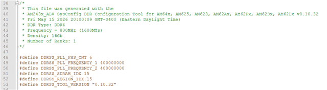

  • On my side, DDR execution compared to MSRAM (first and third column from the TI table above) was around 2.8 longer, but 1.8x longer on TI side. There could be differences on the application design, but are there any specific settings applied somewhere around the DDR controller in your benchmarks? On my side, I used DDR config from SDK, but I also regenerated a DDR config using the DDR config online tool and I had the same results.

  • Hi Gael, for your 3rd question, what changes did you make to your DDR config?  Was same frequency configured?  I'm pretty sure the default config (from the tool) was used for these benchmarks.
    James
    I did not make any changes: I just took the default DDR config coming from AM2434 EVM config in the tool. I was wondering if the online tool may have incorporated any update compared to the SDK version I was using (motor_control_sdk_am243x_11_00_00_06).
    The frequency is 400MHz for 1600MT/s. Here is an extract of the generated file (last week, if I recall):
  • There may be some differences in the DDR config, but i don't think that would contribute to the differences in performance you are seeing.  This seems more likely to be a software differences which are causing different measurements.  I will loop the sw team in.
    james
  • Ok, thanks, especially for the two first questions (stack location and compiler optimization level. If we used the same for both, then I agree with you that it should be due to the software itself.
    Gael
  • Hi Gael,
    The difference between the numbers (2.8x vs 1.8x) would arise from the different sizes of the code and data that the CPU executes directly from DDR. The above table was obtained by benchmarking the OCMC Benchmarking example. Similar numbers to the table would be obtained if this example is being used.
