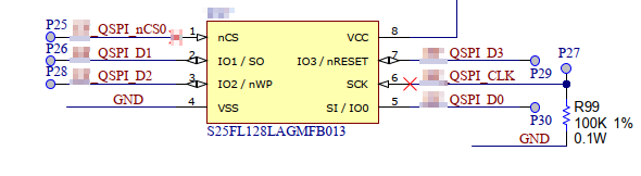

We have custom HW with AM263P4 SOC, TPS6538600-Q1 PMIC and Infineon S25FL128LAGMFB013 Quad SPI flash.
The SBL and application boot and run fine in OSPI 4S mode (SOP_MODE_VALUE_VAL = 0000b) when applying power to the board.

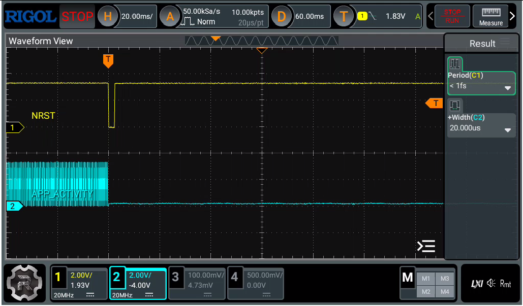

I am developing the PMIC watchdog feature. When I deliberately break the watchdog trigger from SOC to PMIC, the PMIC correctly asserts NRST while keeping the 3V3 LDO on.
However, after NRST is deasserted, the SOC does not initiate loading the SBL and just sits there.
The flash connection is straightforward as follows:
Why doesn't the RBL load the SBL when only PORz (NRST) is triggered please?

    1. Is the nCS, IO2, nRESET line pulled high with a weak pull up?
    No, there are no external pullup resistors on these lines.
    Is the nRST connected to PORz release circuitry?
    No. We're not using the HW reset since the boot mode is QUAD.

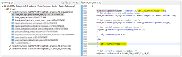

    In the FLASH configuration 4-byte is selected:
    But I checked this through debug and it's hitting the following line which looks like it's setting 3-byte.
    Note also in the screenshot above the code always assumes a OSPI_RESETPIN_DEDICATED. There's no way to select the other option: OSPI_RESETPIN_DQ3 which would be more appropriate for our device, even though we aren't using it because we use QUAD mode. Just an observation.

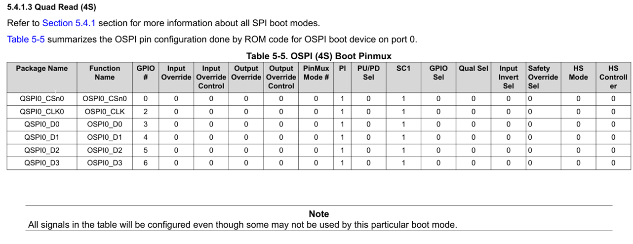

    It is recommended to have an external pull up on these lines. As MCU ROM does not enable the internal pull up on these lines by default.
    Good Catch!! We need not have it in this case as there is no dedicated reset line. Comment OSPI_configResetPin API. Please comment it, save and rebuild the project.

    The RBL expects the flash to be in 3-byte addressing mode during QSPI boot mode (QSPI BOOTMODE = 0000). The reason I mentioned disabling 4-byte addressing mode is to handle potential reset scenarios. The ROM starts booting code from the beginning irrespective of whether the reset was a WARM or COLD reset. After RBL is done, if the SBL or application switches the flash to 4-byte addressing mode and a reset is triggered, the flash will remain stuck in 4-byte mode. Because there is no dedicated hardware reset line for the flash, there is no way to reset it alongside the MCU to ensure it reverts to 3-byte addressing mode for the ROM execution.
    Therefore, the safest approach is to never switch flashes smaller than or equal to 128Mb into 4-byte addressing mode, as a 3-byte address is sufficient to map the entire 128Mb memory density.

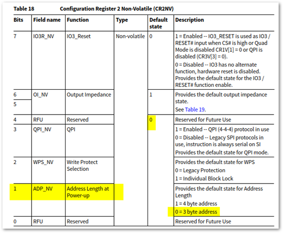

    Why do you think it gets stuck in 4 byte addressing mode after a reset?

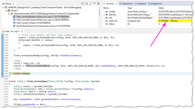

    The device has a non-volatile setting for address mode:
    Since RBL is able to talk to the flash after power on, we can conclude this must = 0, right? I will check its state after the reset command has been issued.
  • I added some code to read the contents of the CR2V register before and after reset.
    BEFORE Reset : Bit 0 is set indicating 4 byte addressing.
    AFTER Reset : Bit 0 is reset (default) indicating 3 byte addressing.
    So at the point of PORz from PMIC, the flash IC is in 3 byte address mode. I think evidence is mounting that this cannot be the cause for a lack of reboot.

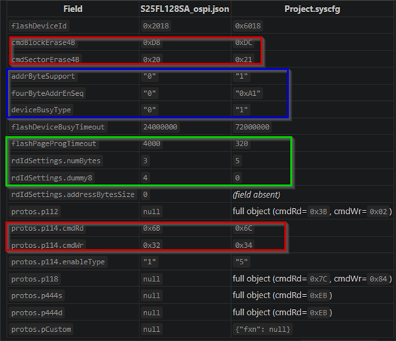

    I reviewed the SysConfig file and noticed that the read, write, and erase commands are currently configured for 4-byte addressing mode. We need to update these to commands compatible with 3-byte addressing mode.
    For example:
    Further Steps:
    1. Untick the "Enable 4-byte" in sysconfig (addrByteSupport = 0 , fourByteAddrEnSeq = 0 )
    2. Update the below to corresponding 3-byte address mode command as in column S25FL128SA_ospi.json.
      1. cmdBlockErase4B
      2. cmdSectorErase4B
      3. protos.p114.cmdRd
      4. protos.p114.cmdWr
      5. deviceBusyType
      6. flashDeviceBusyTimeout
      7. flashPageProgTimeout
    3. Ensure that ospi /flash settings are used in both the SysConfig files of application and SBL.
    4. Save and rebuild the project

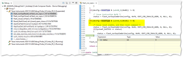

    Thank you very much. I made the 3-byte address changes* to SBL and Application. The latter can now write to flash but most importantly this solves the issue for me, the RBL now boots SBL.
    So it seems then that a software reset request ostensibly changes the addressing mode to 3-byte (CR2V.ADP and CR2V.ADS =0) but empirically it does not. There must be some other factor which means the flash device is not capable of talking to the RBL. Anyway, I'm going to quit while ahead and forget about it.
    *BTW, changing the deviceBusyType produces no change in the SysCfg code but it seems to work regardless.
