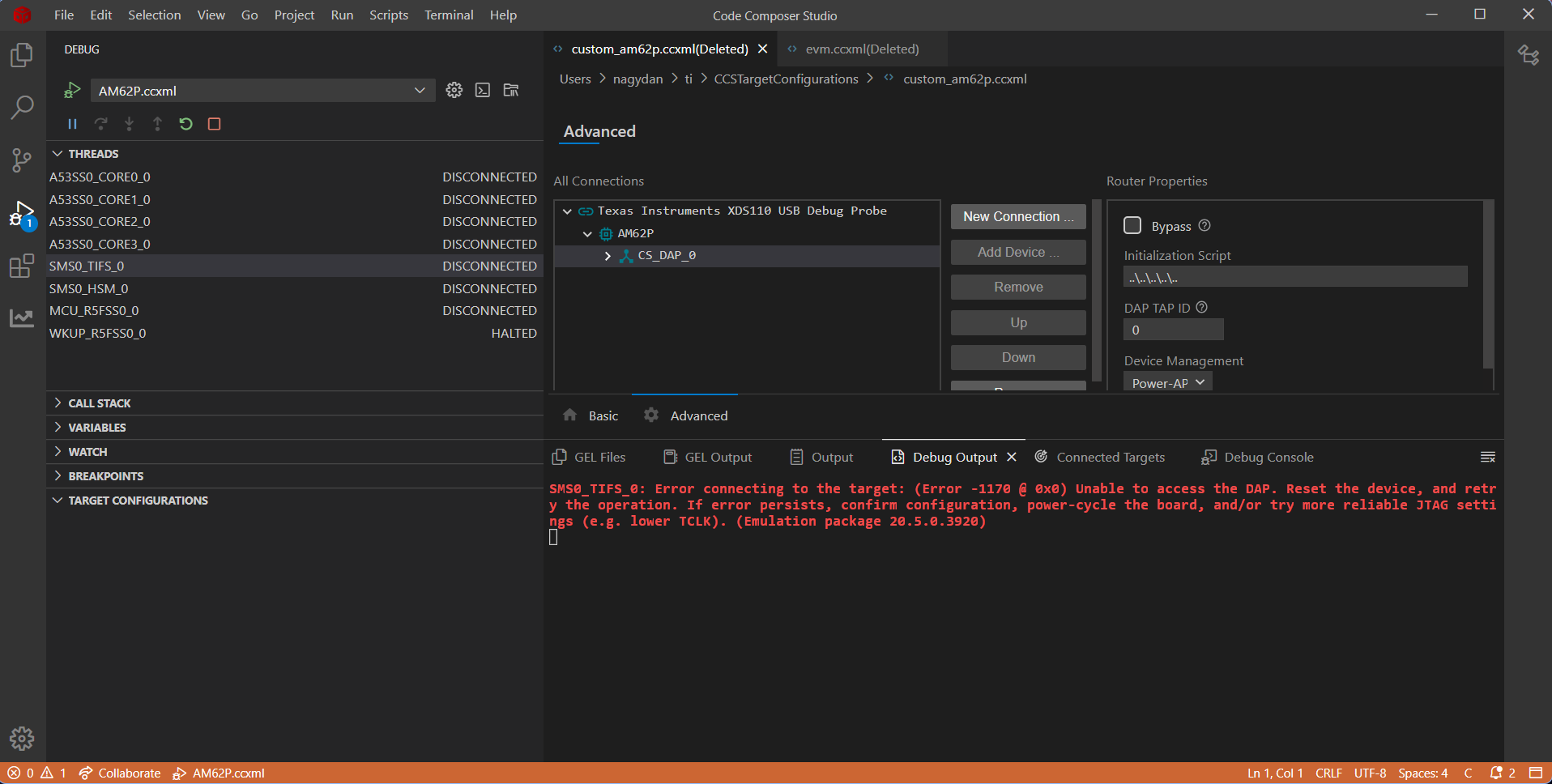

  • Created a new target configuration for AM62P, and connected to WKUP_R5FSS0_0 core.
However, after this, there are no available scripts to run under Scripts in the menubar.
And when I try to connect to core SMS0_TIFS_0, I still get:
Error: (Error -1170 @ 0x0) Unable to access the DAP.
Could you please provide further instructions how to set up the DDR test?
  • Hi Daniel,
    On HS devices, the TIFS core is locked and cannot be connected. You can see in the above attached links as well, it is not mentioned to connect with TIFS core.
    In your target configuration file, select the AM62P_SK_EVM the scripts will then come once you connect with the core.
