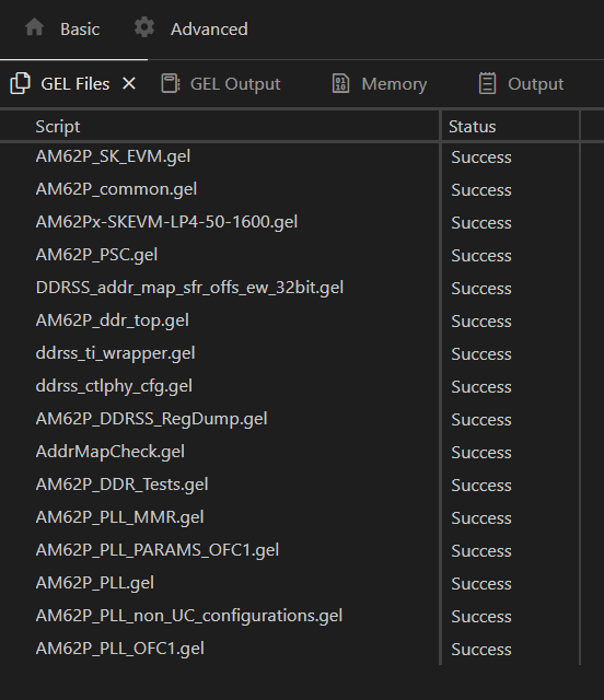

I am able to connect to the board with the XDS110 Debug probe using JTAG, and I can see the DDR test scripts.
I can successfully run  Scripts -> AM62 DDR Initialization -> AM62P_DDR_Initialization_ECC_Disabled.

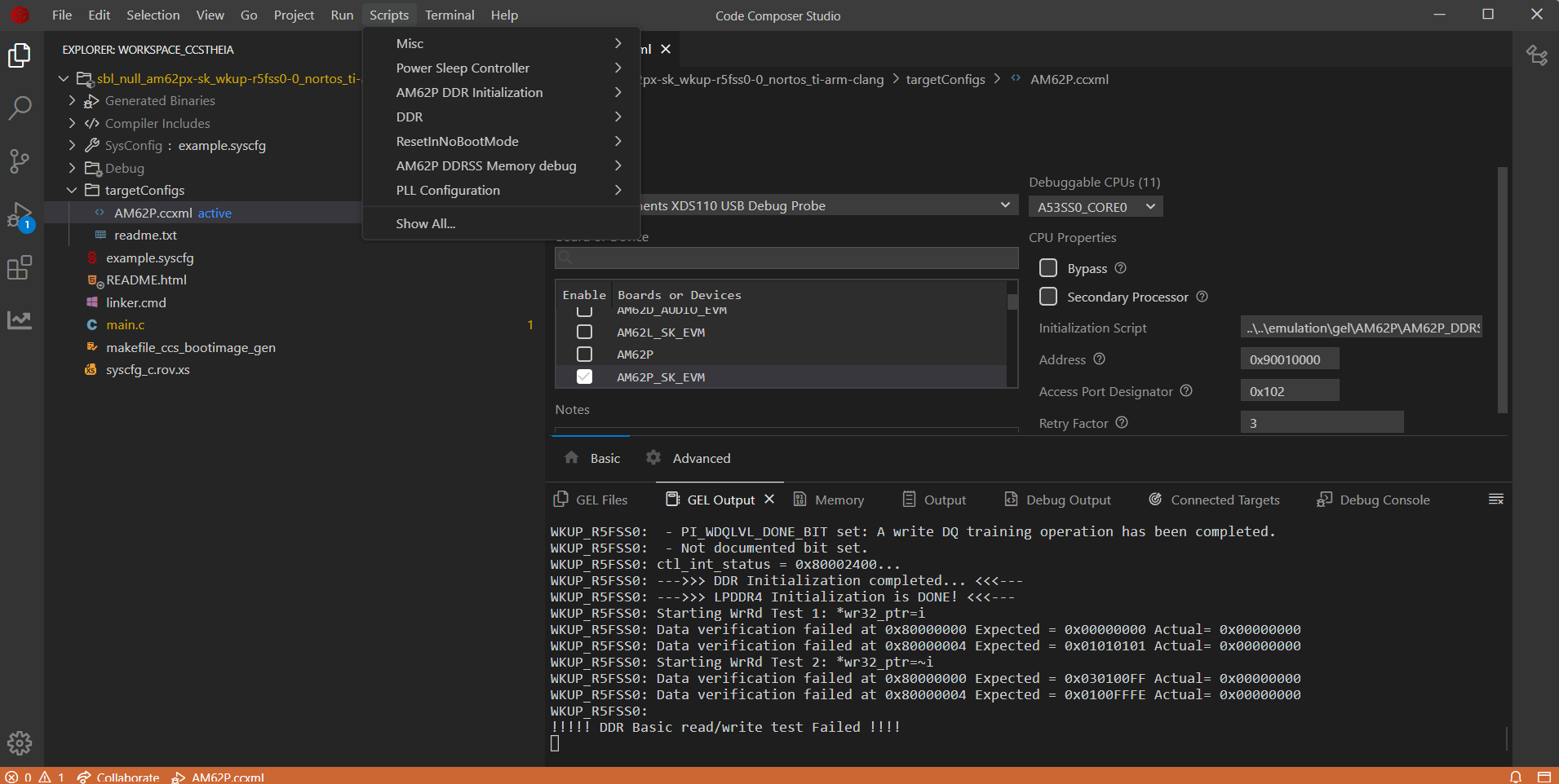

However, when I try to run Scripts > AM62P DDRSS Memory Debug > Data Tests > Data_WrRd_test, I get:
!!!!! DDR Basic read/write test Failed !!!!
I am using a fresh install of CCS 20.5.1, I have not modified any DDR timing/config parameters, and I am using the out-of-box files provided with CCS.

WKUP_R5FSS0: Starting WrRd Test 1: *wr32_ptr=i
WKUP_R5FSS0: Data verification failed at 0x80000000 Expected = 0x00000000 Actual= 0x00000000
WKUP_R5FSS0: Data verification failed at 0x80000004 Expected = 0x01010101 Actual= 0x00000000
WKUP_R5FSS0: Starting WrRd Test 2: *wr32_ptr=~i
WKUP_R5FSS0: Data verification failed at 0x80000000 Expected = 0x030100FF Actual= 0x40007300
WKUP_R5FSS0: Data verification failed at 0x80000004 Expected = 0x0100FFFE Actual= 0x41004100
WKUP_R5FSS0:
Given that DDR initialization completes successfully and all training steps report done, I was expecting the basic read/write test to pass without needing any modifications.
Has anyone seen this behavior on the SK-AM62P-LP EVM with the default GEL configuration?
Could I be missing a required step?
  • I can recreate this issue on my EVM.  I'll have to take some time to investigate this.  If you connect to A53SS0_CORE0_0, it will automatically initialize the DDR correctly.  For now, please use this method to init DDR.
    James
  • It appears the GEL script runs faster with the WKUP_R5FSS0 core.  If you add the delay below, the GEL script will run correctly:
    printf("Clearing the ack bit...\n");
    HW_WR_REG32((WKUP_CTRL_MMR0_CFG0_BASE + DDR4_FSP_CLKCHNG_ACK), 0x0); //clear the ack bit
    us_delay(3000);
    printf("--->>> Frequency Change request handshake is completed... <<<---\n");
