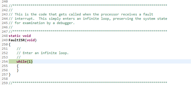

  • Hi Erik, for some reason, I don't get compilation errors now. I went back to the original TM4C1294 project, made sure it compiled. Then, in project properties I just switched to TM4C1299 part and it compiled this time. However, when I run it, it gets stack in FaultISR (please see picture). This is a fault interrupt. Is there a difference between TM4C1294 and TM4C1299 as far as interrupt signal pins? Am I missing a signal?

  • Hi Felix,
    Could you check the IPSR register?
    this will tell us if this was caused by what type of fault. My assumption is the memory map of these two devices will be slightly different and a certain IP maybe mapped in a different memory location.
  • Hi Eric, when I switched to TM4C1299 device, compiler created new startup_ccs.c and enet_s2e_ccs.cmd files. New files are: tm4c1299nczad_startup_ccs.c and tm4c1299nczad.cmd. For some reason, when compared with the originals, the new files were missing some memory and register initialization instructions. I added the missing instruction to both files and also excluded the old files from compilation.  The application doesn't crash now
