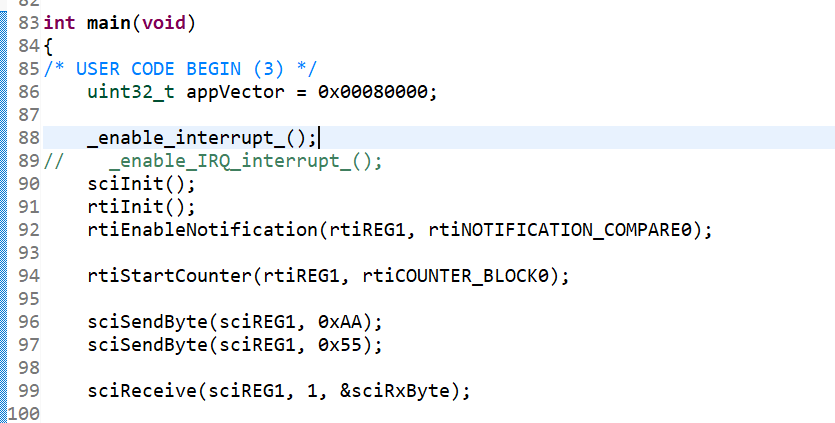

I have implemented serial port interrupt-driven reception and resend data from that serial port. When the APP program is located at address 0 and the serial port interrupt is in either IRQ or FIQ mode, everything works normally. However, when the APP program is located in sector 10, regardless of the serial port interrupt mode, calling the _enable_interrupt_() function causes the program to crash because the serial port does not transmit 0xAA55.

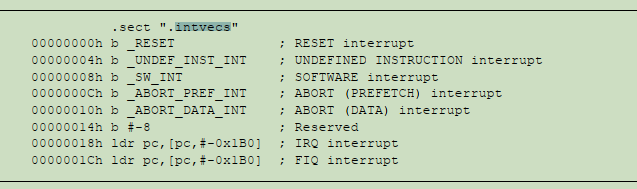

Is this because the FIQ is fixed at address 0x0000001C, and when the _enable_interrupt_() function is called, the program jumps back to address 0x0000001C, which has no content, causing the exception?
If my assumption above is correct, would redirecting FIQ and IRQ to SRAM within the app resolve this issue?
Actually, I’ve already tried performing this action as described in the spna263 documentation, but it didn’t work.
I'll attach my code. Could you please take a look and see where the problem lies? Thank you.

  • Hi gundavarapu,
    I’d like to add some more information I’ve recently discovered.
    1. Program for Jumping to Address 0
    resetEntry
            bl   _mpuInit_
            mov r0, #0x0000       ; low 16-bit
    		movt r0, #0x0008       ; High 16-bit
            bx	r0
    undefEntry
            b   undefEntry
    svcEntry
            b   svcEntry
    prefetchEntry
            b   prefetchEntry
    dataEntry
            b   dataEntry
    2. The app is located in sector 0. Case where an app verifies that a serial port interrupt is an IRQ
    2.1 Call the functions _coreEnableIrqVicOffset_(); and _enable_IRQ_interrupt_();
    The serial port is functioning normally at this point, but debugging reveals that the program does not execute up to the `irqEntry` point.
    2.2 Call only the _enable_IRQ_interrupt_(); function; do not call _coreEnableIrqVicOffset_();
    The serial port is functioning normally at this point, and debugging reveals that the program frequently executes up to the `irqEntry` point.
    3. The app is located in sector 0. Case where an app verifies that a serial port interrupt is an FIQ
    Since the _coreEnableFiqVicOffset_(); function is missing, only the _enable_interrupt_(); function is called. At this point, the serial port is functioning normally, but debugging reveals that the program frequently executes up to the FiqEntry point.
    4. The app is located in sector 10. Case where an app verifies that a serial port interrupt is an IRQ
    4.1 Call the functions _coreEnableIrqVicOffset_(); and _enable_IRQ_interrupt_();
    At this point, the serial port is functioning normally.
    4.2Do not call the function _coreEnableIrqVicOffset_(); call only the function _enable_IRQ_interrupt_()
    At this point, the serial port is not functioning properly.
    5. The app is located in sector 10. Case where an app verifies that a serial port interrupt is an FIQ
    At this point, simply calling the _enable_interrupt_(); function will cause the program to crash.
    6. Conclusion
    6.1 The serial port, configured as an IRQ, works normally in sector 10 because when the interrupt occurs, the program does not jump to 0x00000018 when calling the _coreEnableIrqVicOffset_(); function. I would like to ask what the purpose of this function is.
    6.2 The interrupt mode set to FIQ for the serial port does not function properly in sector 10 because, when the FIQ interrupt is enabled, the program jumps to address 0x0000001C, which is empty, causing an exception.

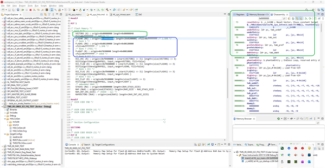

    I understood the root cause for the issue!
    Here is explanation:
    • The exception vector table on TMS570 Hercules devices is fixed at address 0x00000000
    • Unlike Cortex-M3/M4 (which have VTABLE register for relocation), Cortex-R4/R5 does not provide hardware-based vector table relocation

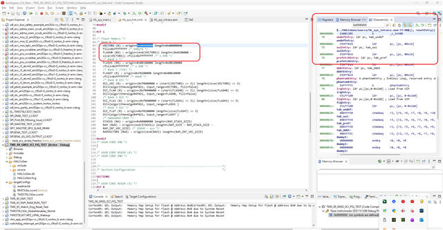

    So, when your linker cmd file is as below:
    As you can see there is no proper vector table at address 0x00000000, but if controller got reset the core will always expect the vector table to be at 0x00000000. That is why it is crashing.
    You can do below method to avoid this problem:
    As shown above just try to keep vector table at starting of the flash and you can keep remaining code wherever you want that doesn't matter. So, only vector table (0x40 size in your case should need to be at starting of the flash). Now you can see there are valid jump instructions at starting of the flash right, so whenever warm reset or POR reset happens the core will jump properly to the init function and performs the execution properly without any crash.
    I tested at my end after above modification and it is working fine without any issues; here is the code for the same for your reference:
    TMS_09_GNSS_SCI_FIQ_TEST.zip
    Here are the test results after above suggested modification:
